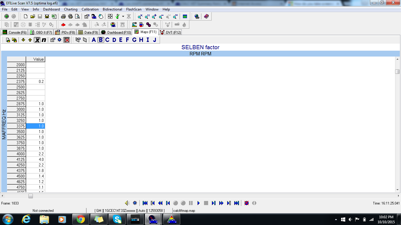

In the map properties, on the Data tab set Precision to 3 or 4.

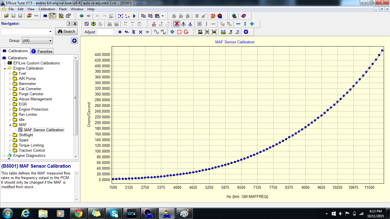

In your map, I see some values creeping too far from 1.0, namely 2.2, 4.0, 2.2, 1.8 and others... your MAF table can't be that far out, post a pic of it.
Post new log and tune files.

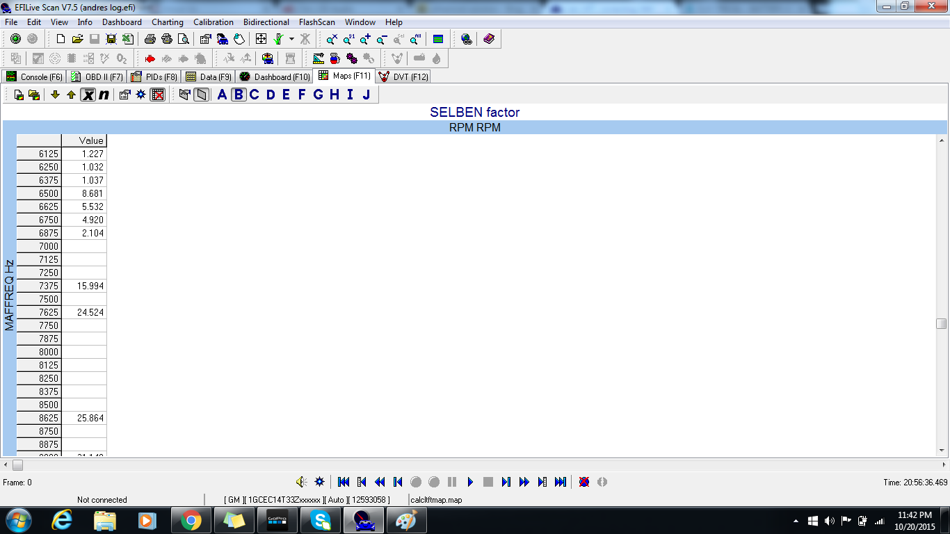

alright i finally got back around sorry for taking so long. what all am i doing wrong here??
No worries...
post some screenshots of the steps you did...
