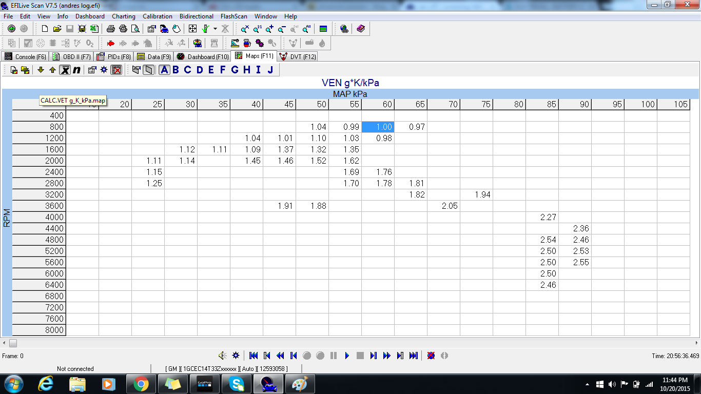

Attachment 18960
i took the above maps created by the calc ve tutorial but i think i must have something wrong in the pids or the maps... can any of you view my created maps through my log i posted?
Something is wrong with the values of the pid EXT.WO2LAM1, they should range from 0.5 to 1.5.
Which wideband are you using (did you say LM-2)...? Something is wrong with it.
Can you log it's 0-5V analog output to see if it correlates...?
yes it is the lm-2. i am trying to trouble shoot that issue. do i need to be looking for a problem with the wideband controller itself or something incorrect with how i have my scan tool setup. sorry i feel so dumb on this. i am not understanding how i am getting wideband data on to the scan tool yet that one pid is showing what it is.
My calc.vet setup on the scan tool, something is not right. And when I click on the calcpids in the beginning of this post an error comes up saying that calcpids is an invalid efilive file
I just clicked on the calc_pids.txt link at the beginning of post #1 and it opened ok in Windows Notepad...
when you click on it you want to save it to your PC (i.e. do not open in as an EFILive file).
