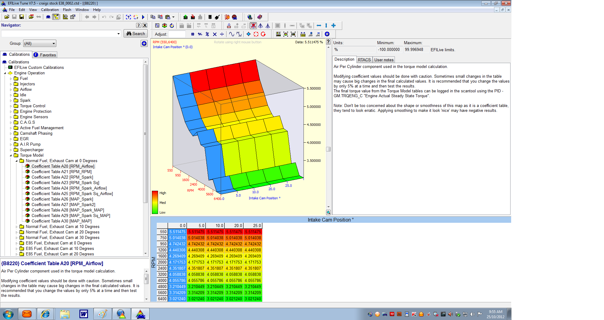

OK guys here is the screen shot
is it just the first 0.0 column in the TORQUE MODEL (highlighted ) that is upped by 15% ,OR the whole table

Whole table

Rhino,
i'm assuming that it would be best to start with THE stock T43 tune ?
as the one i have in at the moment has had shift pressures and shift times , etc altered
Yeah, go back to the shock tune. You can change the shift times down a bit still or it will always battle to get them back to what it thinks it wants.
The other thing to consider, if you don't want harsher shifts at lower RPM's, don't mess with the torque table down there.
As for the Cam degree axis, for the Commodore it doesn't matter, just change all columns.

well i upped the torque model 15% in the E38 and it didn't do any thing that i can feel to my MODED a6 tune ??
if you select NO in the torque management T43 on wot up shift does that cancel out the the torque table ?
6l80e
UP DATE
just for fun i reloaded the STOCK T43 tune with the + 15% in the the ecm WOW its just as good as the modded tune
and with the torque management set to NO in D9401 AND NONE in D9412 and D9414 its better then the modded tune a lot nicer shifts AND THE MANUEL SHIFT is way better it has got some real feel now
