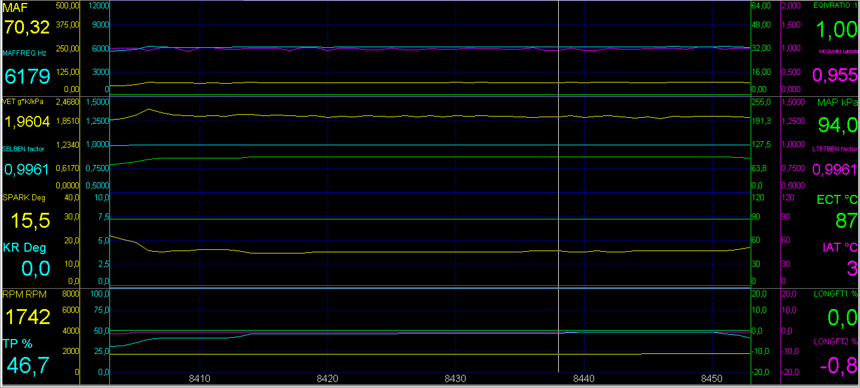

Yes.. Its way leaner than I would like. Except when in PE mode. Cant hear the ping, but I see knock on the logs.
Here
Used the ltftben from the first log and made adjustments to the maf calibration. logs now show close to zero ltft :) No more knock retard :)
Attachment 21050
Tok another drive/log and did some adjustments to main ve. Probably need some more logging/smoothing. But does it look reasonable ?
Attachment 21051
Good job :cheers:
VE looks quite good (did you use LTFTBEN...? did you disable the MAF when adjusting the VE)...?Quote:
Attachment 21051
I don't know how high your engine revs, but for safety bump up the VE table from 5200 thru to 6400 or 6800 rpm.
Thank you :cheers:
I followed the Calc VET tutorial to calculate the VE table. Used "Calculated VE, BEN corrected (g*K/kPa)" so the VE is calculated with data from the MAF ?

Yes, VE is calculated with corrected MAF data.
