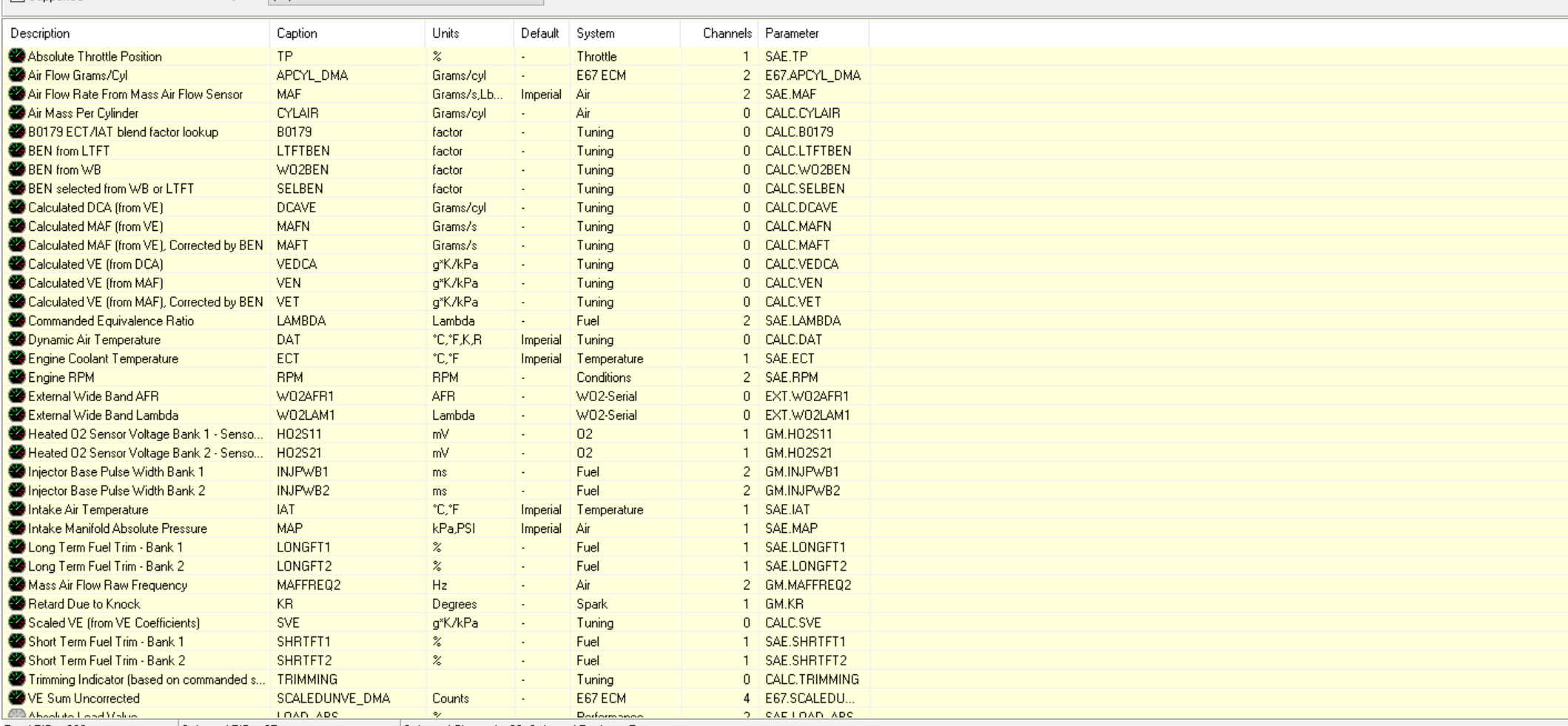

BADCADDY,
Here is the E67 calc_pids.txt file, rename it to calc_pids.txt, move it to folder C:\Users\<you>\Documents\EFILive\V7.5\User Configuration
then start the scantool, select the pid CALC.WO2BEN and/or CALC.SELBEN, and then on these same pids go rightclick->More Info to see which other pids need to be selected also.
In your tune file, table B0179 is all zeros, which I was not expecting, so in the calc_pids.txt you will see that the pid CALC.B0179 looks up zeros... when you get table B0179 populated with better values, we can update the pid CALC.B0179 with the same values.
Hey Joe,
Doing some logs tonight and will post them up, just double checking PID list looks good ?
Attachment 21630
