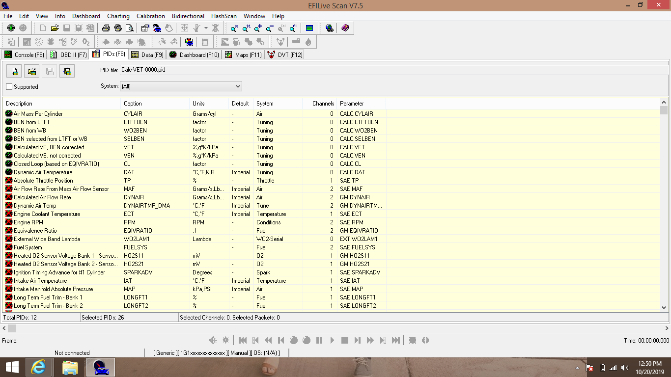

My hard drive recently crashed and I had to reinstall EFI live. I'm having trouble with the PID selection in my scan tool now. I copied the Calc Pids into their proper location, but a bunch of other pids are now invalid. If I right click for more information, they do not tell me why they are invalid. Please see the screenshot and advise. Thanks!
Attachment 23054
I apologize. I forgot to actually connect the flashscan to my controller. Seems to be fine now!
Ok, you did Info->Validate Pids and now they are valid...
