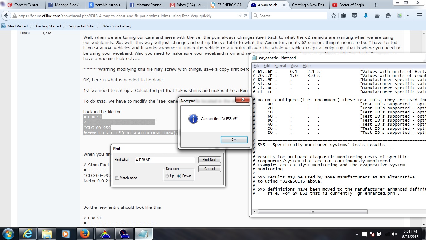

I know this thread is dead but maybe somebody will help. I'm trying to use this method and I can't get past the first step. I opened the sae_generic.txt file and I can't find the section to modify. I have looked through the whole file several times. Also, since I'm using an LS1B instead of an E38 I would imagine I should be looking for a similar line using LS1B instead. Is this method still viable in 2015? Did the sae_generic.txt file change in the current version? Lost and confused like always...
E38/E67 and later do not have VE...
Also, should really create your pids in calc_pids.txt to avoid losing them when sae_generic.txt gets overwritten on each V7 software update.
Thanks for the help once again joecar. I guess I wasn't very clear. I'm not sure what text to put where in the file. I'll take your word on using calc_pids.txt instead of sae_generic.txt. I know E38s don't have a VE table but the first post in this thread talks about finding "# E38 VE..." in sae_generic.txt. It's not in the file and I don't think that's what I would be looking for any way since I'm using an LS1B. I'm really trying to understand this but it's a bit over my head at this point still.
