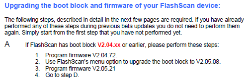

Looks like I'm having a similar problem as the OP.
My current Flashscan firmware version is 2.4.70.
I downloaded the "Upgrading FlashScan.pdf" and noted the following instructions...
Attachment 16543
...about needing to do a multi-step firmware update from a version as old as mine.
But my searches for those older version firmware updates either come up empty, or I find pages like this one (which appears to be too new anyway) that have download links that do not work.
If anybody knows where I can find the older firmware updaters I need, I would appreciate it.
You need to first update to V2.4.72 using the V7 firmware program:
Start->All Programs EFILive->V7->EFILive Firmware Programmer
^ I assume that is accomplished by using the file "FSProg_V2_4_72.ffw" that is included with the V7.5x installer?
What had me confused is these instructions: don't seem to apply (at least I couldn't find the "F6: Device Settings" option in the left-hand pane).

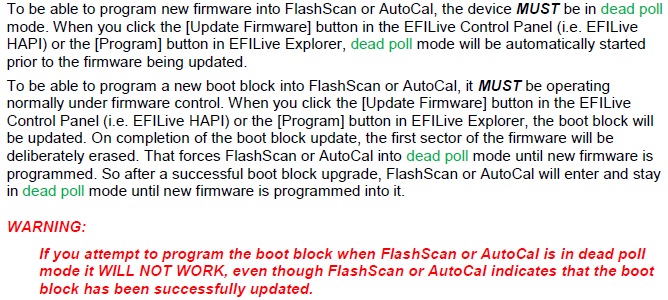

Anyway, from what I see here:
Attachment 16545
The boot block has to be updated first. The Flashscan must be in the "normal" mode to do this.
Then the firmware has to be updated, and Flashscan has to be in the dead poll mode to do that. But the Boot Block update automatically puts Flashscan in that mode.
One thing though, this says:
Attachment 16546
FlashScan and AutoCal are designed to be field upgradeable and have been configured with two distinct software modules:
1. The boot block.
2. The firmware.
I only see the one file "FSProg_V2_4_72.ffw" in the V 7.5 folder. (evidently the filename extension changed to ".efw" in the current format)
While this page says "Note: Always update the Bootblock version first"
apparently in the case of the older (legacy) firmware, the upgrade to firmware version V2.04.72 must happen FIRST, as per these instructions.
Sorry if I'm seeming a bit slow on this, but the problem is seeing instructions that conflict, apparently because the legacy stuff is a little different.
Most instructions (that have been written in the past few years) about the firmware and boot block only applies to devices that are running boot block and firmware versions V2.05.xx or later.
Get your device to firmware V2.04.72, then perform the build in boot block upgrade to V2.05.xx, then you can start using the various instructions that you have listed above.
