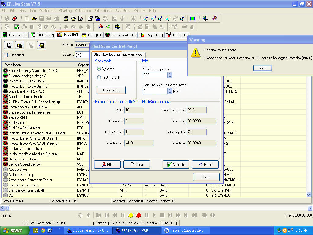

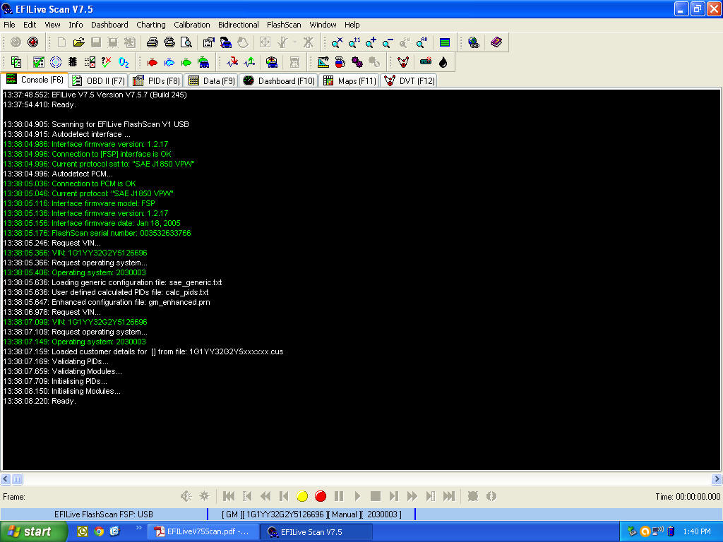

Launched old laptop from roof of car. Downloaded V7.5.7 Build 245 on different XP laptop using FSP 1.2 . Overcame the licensing but am unable to load PIDS for BB logging. Help would be much appreciated.

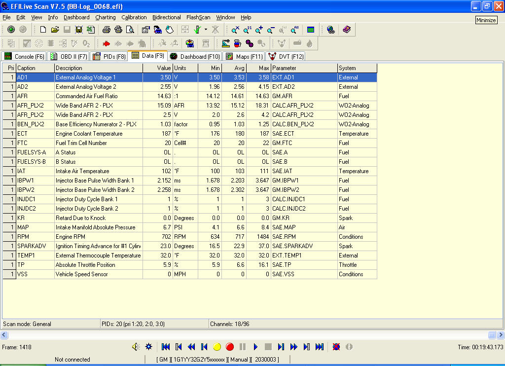

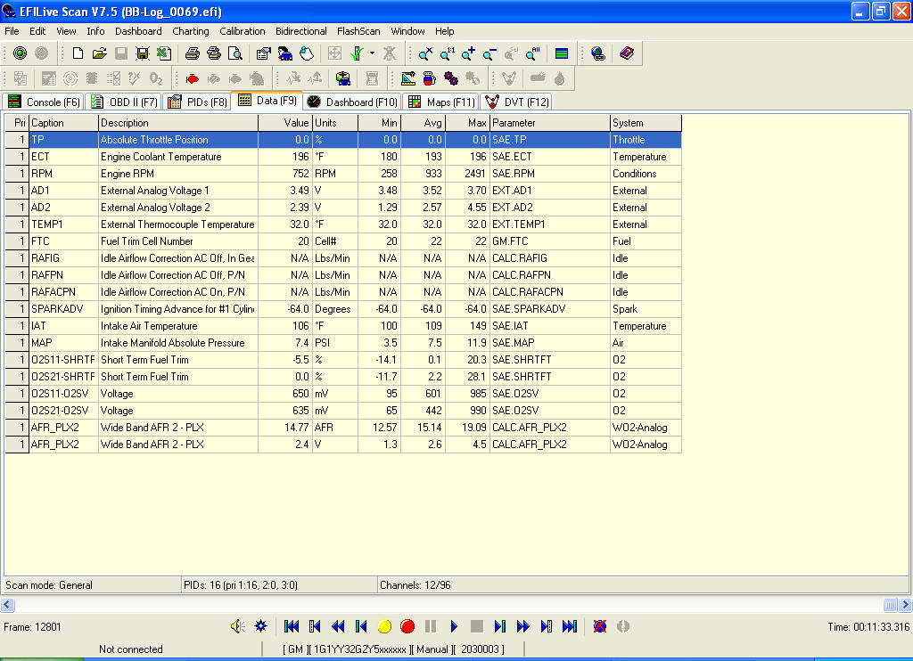

I use a V1 for BB and ver 7.5 is the latest upgrade. I actually loaded PIDs to black box while connected to PCM. Forgot to mention I use COS 200303. Logs correctly straight to computer but BB logging the same PIDs 60% are showing N/A. Am suspecting a failed cable

Your PIDs tab shows 19 selected pid and 0 selected channels...?
Try this:
on the FlashScan Control Panel (for V1) do this:
- select Fast (10 f/s),
- set Max Frames Per Log to zero (i.e. unlimited),
- click Validate;
- follow the instructions it tells you (it will tell you to connect V1 to vehicle and let it validate, and then to bring it back to PC).
Followed our instructions up to validate, was warned all log files would be erased, clicked yes to continue and was told Flashcan is now ready for validating pids.No further instructions.
I thought all colored pids where selected. How do you select channels?
Ok... (it's been a long time since I did V1 BBL)... I sent Paul an email for further guidance
( the channel count should not be showing up as zero )
It's been four years since I tuned my ride. Fell into a brand new hole here. Flashscan control panel reports 1 total log file plus time/log @ 01:13:38 and total time @ 01:13:38. Looks like its gorged.
Try this: click the Progam Pids button.
