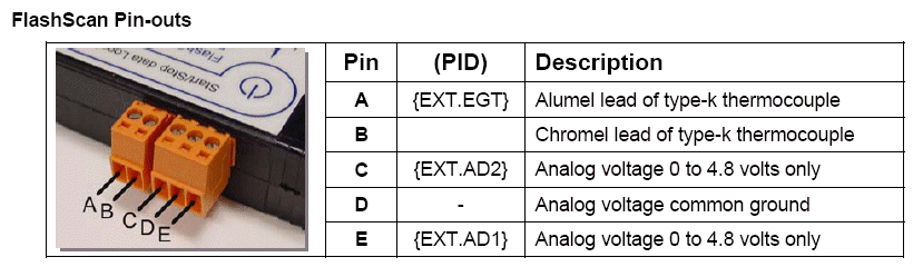

I see that the new cable comes with an input for a K type thermocuple. I've never delt with thermocouples, except for the theory of their operation. Do they come in different voltage output ranges for different temperature ranges?
Hows about a little discussion of their variations and use. I'm trying to come up with some good uses, especally for a turbo setup.

Turbo setups were exactly what we had in mind, alot of guys like to measure the exhaust temp of the turbo's, or the temp after an intercooler.
Look to get an decent EGT from the aero industry, they are widely used on piston planes.
Alot of dyno's have Thermocouple sensors as well, they are handy for measuring under hood temps, intake temps, etc.
Not that we have provision for 8 thermocouples but alot of the big end drag racers run 8 so they can picky lazy or lean cylinders.
Simply put you can't measure 0 - 1024degC using the air intake temp sensor GM provide :-).
