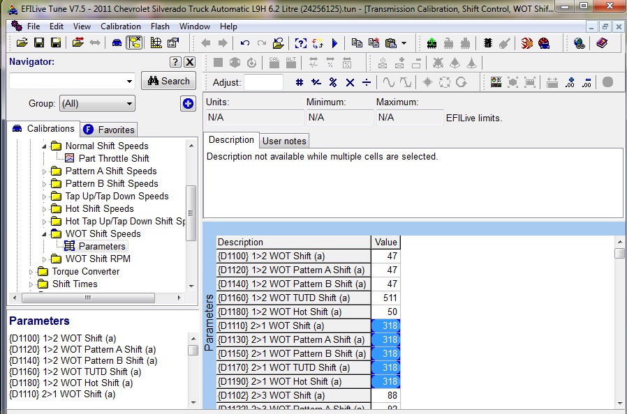

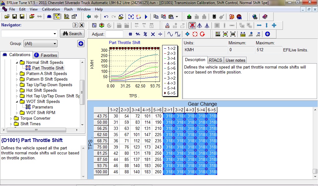

Looking at my log, it looked like the first downshift from 4->3 was at 41 MPH which matched up with the values in table {D1001} I tried adjusting them for all gears up to 100MPH to try and keep it from downshifting. Still downshifted:doh2:
Are there any suggestions on what needs to be changed? Ideally I would like to do it with the scantool only so I wouldn't have to license a vehicle everytime I want to put a vehicle on the dyno.
