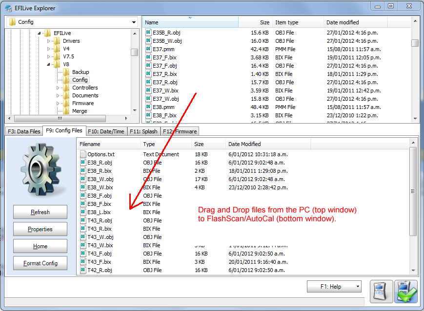

The *.obj and *.blx files can be found on your PC in the folder:
\Program Files\EFILive\V8\Config (for WinXP and Win2K)
or
\Program Files (x86)\EFILive\V8\Config (for Vista and Win7)
You can copy them to FlashScan or AutoCal using EFILive Explorer. They must be copied into the [F9: Config] tab page.
Attachment 12615
