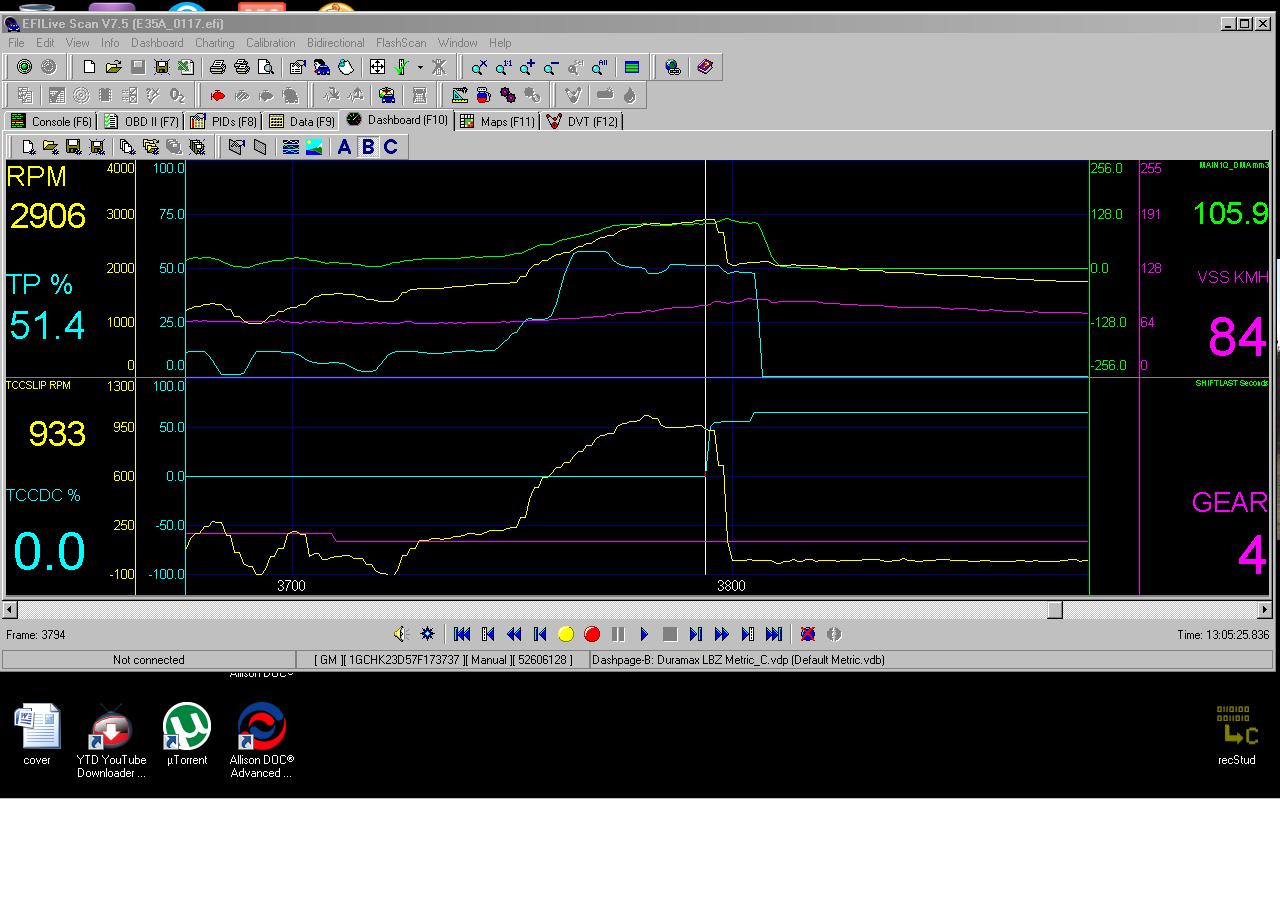

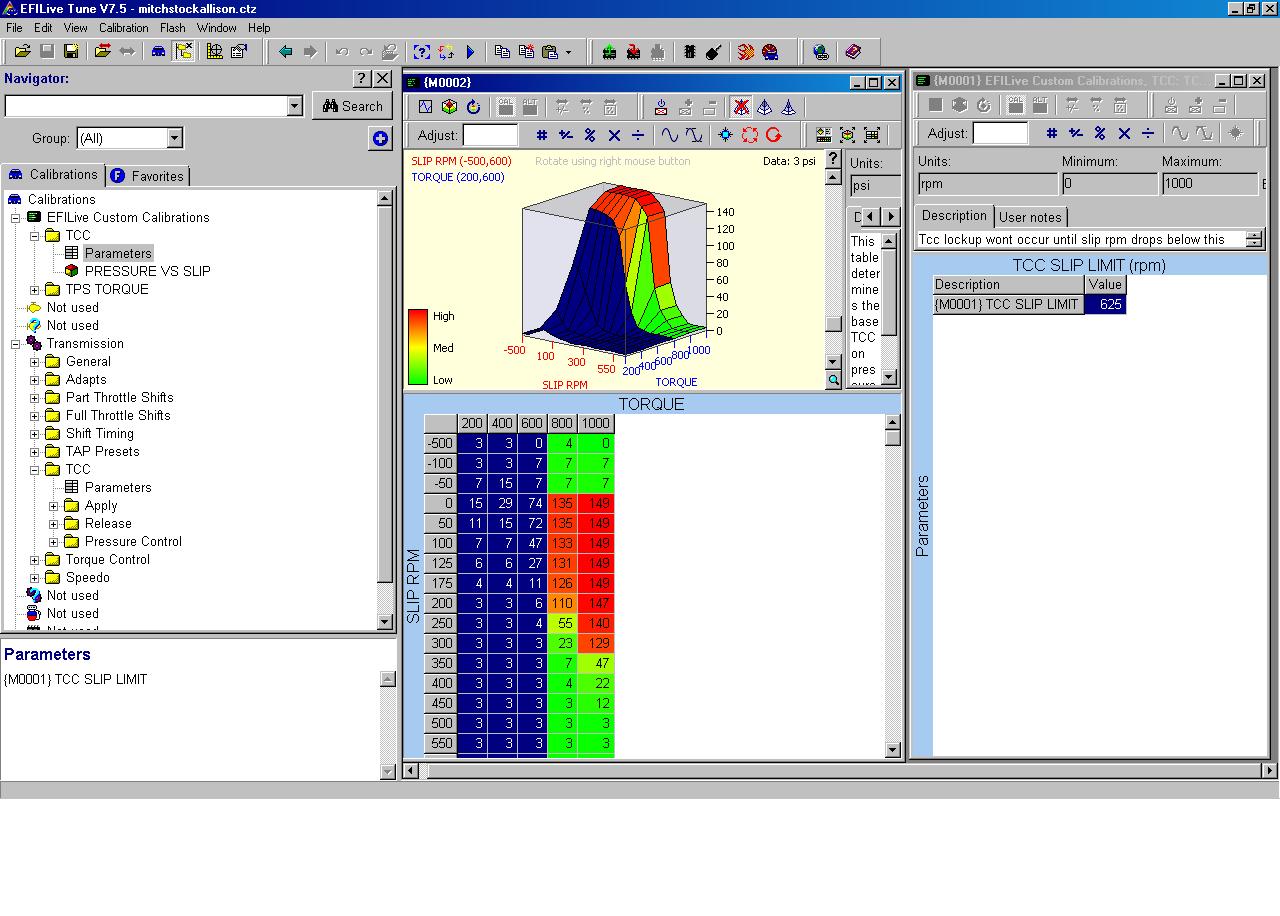

Hey guys figured I better make my first post here a good one so here it is, after countless nights awake reversing code in the a40 tcu
I HAVE FOUND AND AM ABLE TO CHANGE THE FACTORY SLIP LIMIT 625rpm!!!,
her is a log proving I have done this! I would like to test this on a few others so for anyone who wishes for me to change your limit send me a copy of your stock tcu file and i will change it to whatever you like.
I got a full binary from ross and decompiled with idapro. There is also two more colums in the tcc on ramp rate that arent available in the current
efilive calz file, this and 900+ rpm slip at lockup in third will break the tires loose!
Attachment 15224

Any updates on the 5 speed TCM?
600 rpm slip limit solved!!!! OS 25941752
Modifications have been made. We just need to regenerate the cal files and include them in the next beta release. Once tested they will move into a public release.
Cheers
