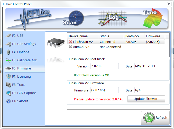

The boot block software for FlashScan and AutoCal has been updated to increase the stability of flash memory erase and flash operations under varying environmental conditions. You should update the boot block in your FlashScan and/or AutoCal devices when prompted to by the EFILive Control Panel. If you are not prompted to update the boot block, please manually run the EFILive Control Panel software, select the [F6: Firmware] tab page and update the boot block. After updating the boot block the device will remain in dead-poll until you reprogram the latest firmware into it.

Boot Block: V2.07.05 (May 31, 2013)
To view the installed version, Select F7: Licenses (in the V8 Scan and Tune software).
Firmware: V2.07.45 (June 6, 2013)
