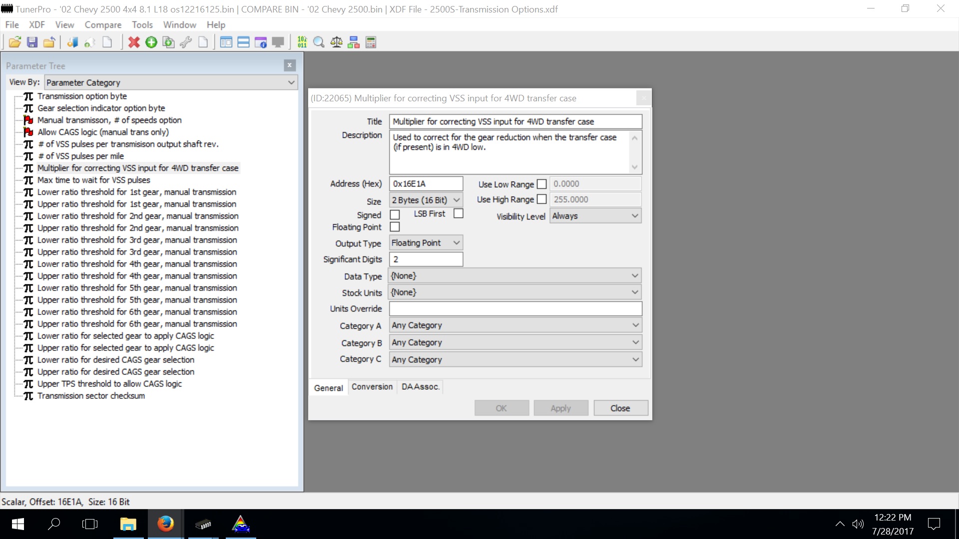

1 Attachment(s)
I found something that might be helpful for creating a CAX file.
Attachment 21326
Yes, the Tuner Pro XDF files are very helpful. I have learned a lot by studying those, looking at BIN files, and reading a disassembly from a 2001 OS. It looks like this XDF is for a 12216125 OS. The address that is listed is slightly different than the one that I have. Do you mind sharing the XDF file, or where you found it?
I found the xdf here.
https://www.thirdgen.org/forums/diy-...k-00-01-a.html
I doubt that it will work for the 12212156 OS that I want to use though.
12212156 is very similar to the 2001 OS's. The flex fuel 2002 OS (12216125) is where the 02 OS's get a little different.
From looking at the binary files from different vehicles, I think that the address that is shown in the XDF file is slightly off. In general though, what you are showing is basically what would need adjusting in your flash file.
