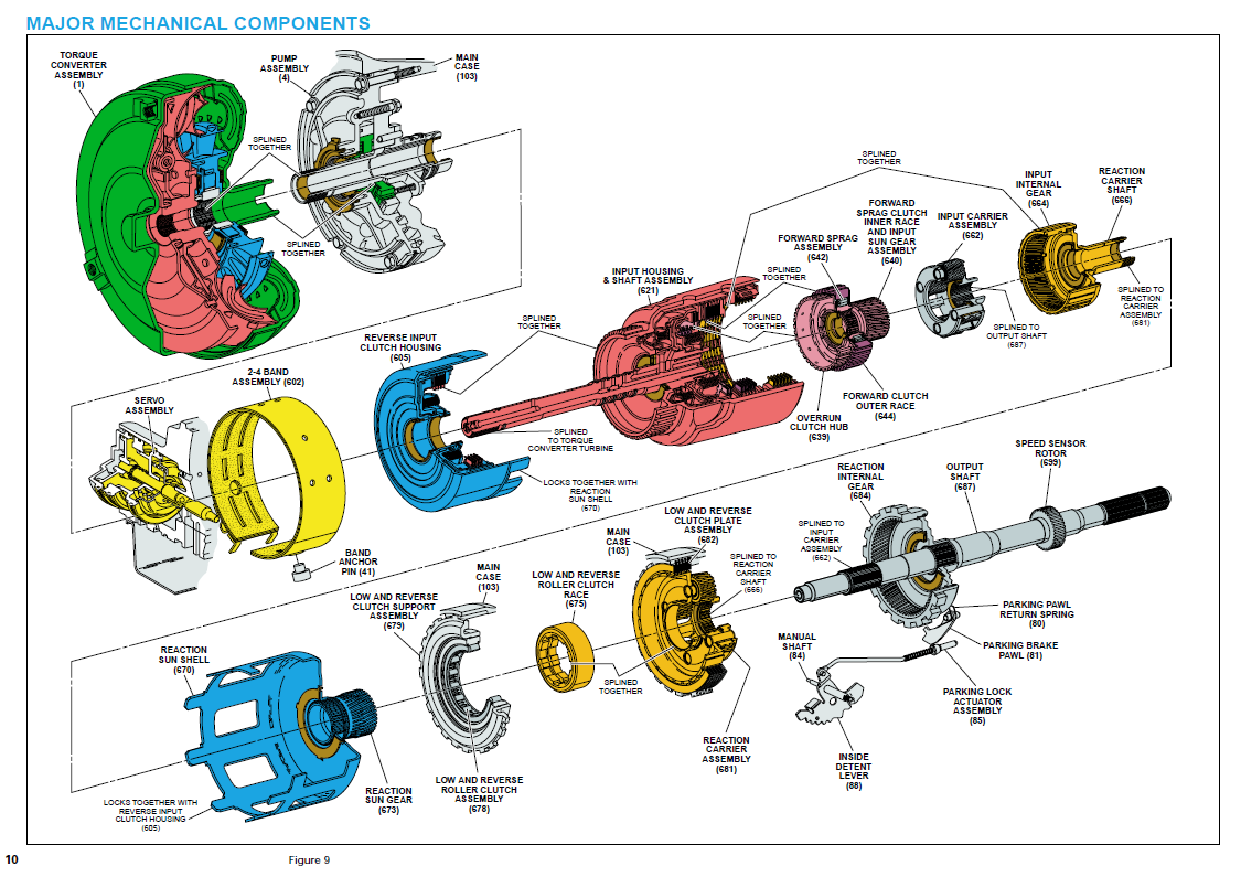

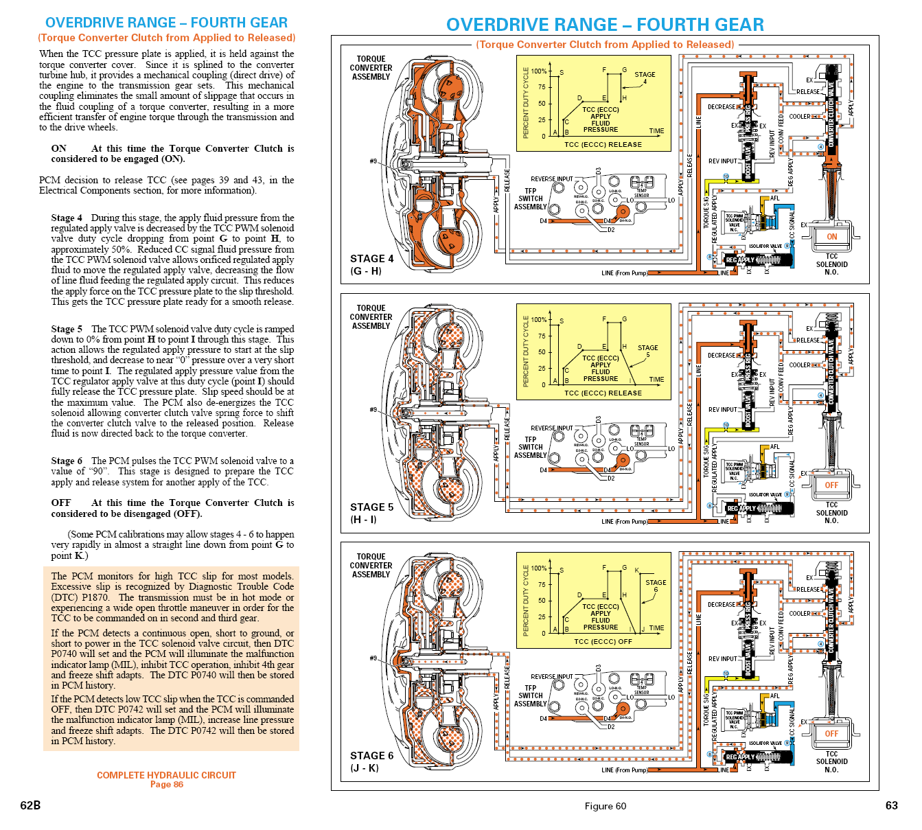

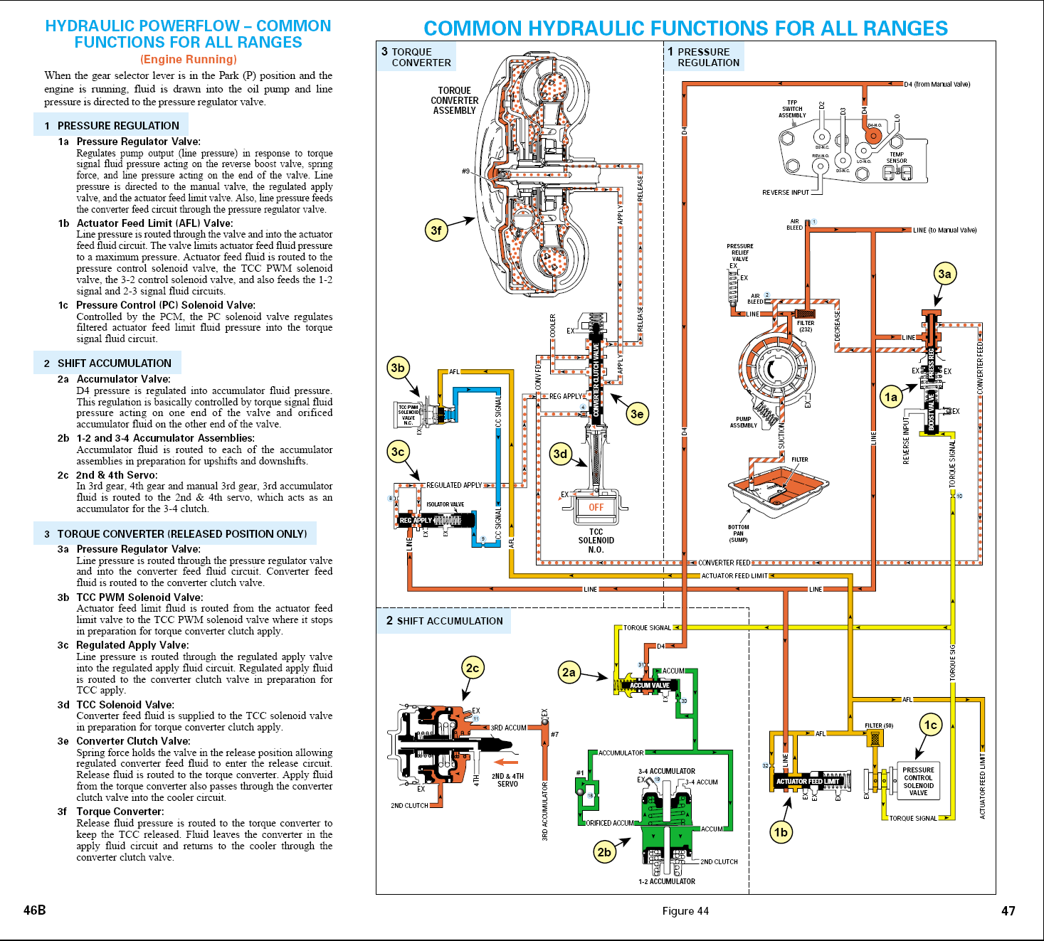

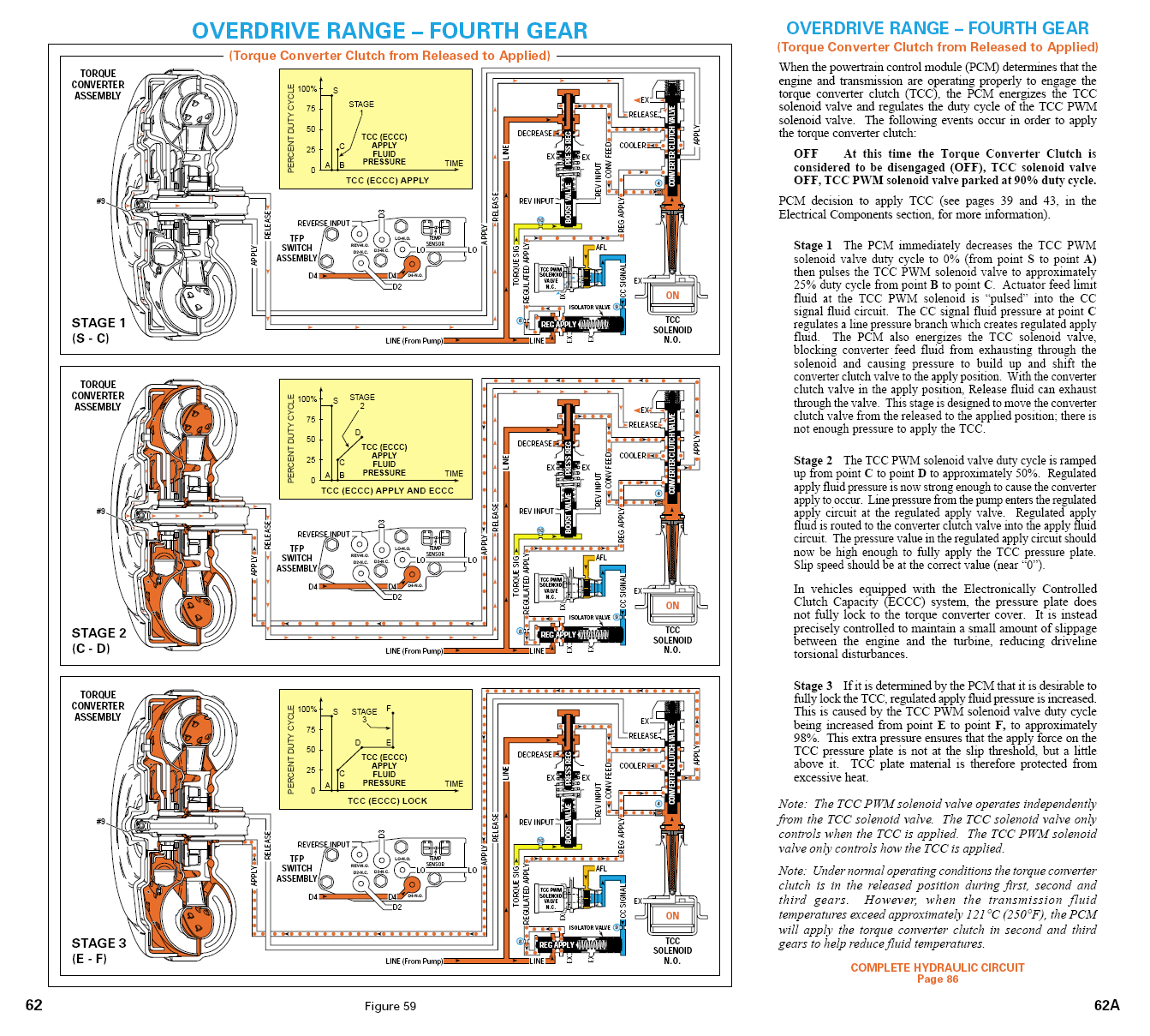

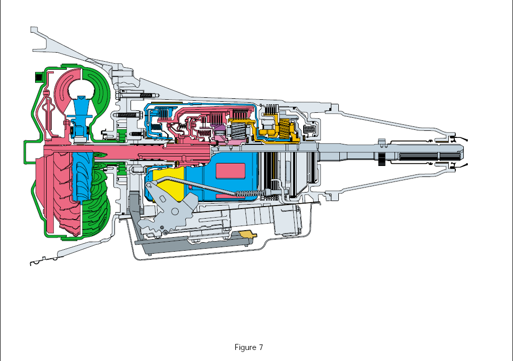

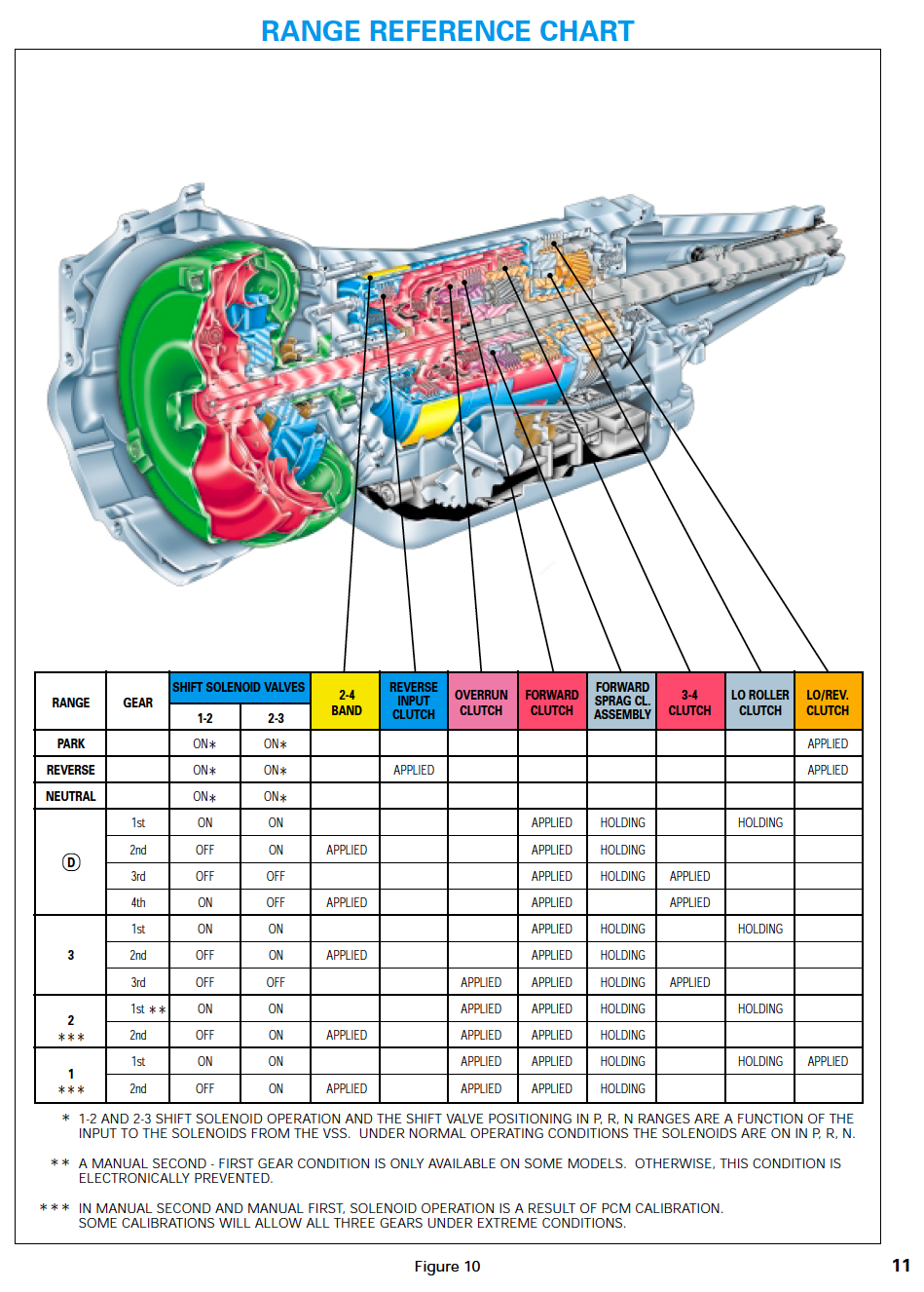

Here are the docs that I have it is an 8MB package and contains the following..
hydra-matic.4l60-e.electronic.controls.pdf
4L60-E hydraulic schematic key.pdf
4L60-E hydraulic schematics.pdf
4l60e manually shift conversion.pdf
4L60-E Overhaul.doc

Yes, 4L60E suffering no 3rd or 4th typically is 3/4 clutch failure.

so the tcc is commanded at light cruise in 4. and at wot in 2. and 3. gears?
