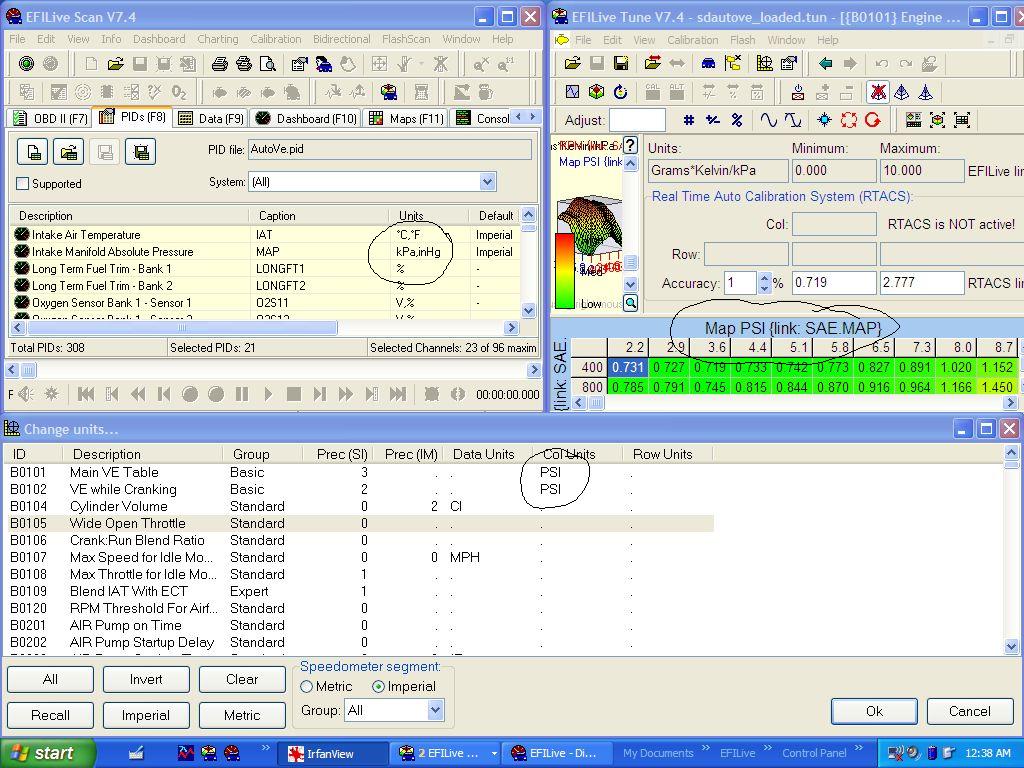

I don't know about you guys but I cannot make out anything on this picture. Maybe if you save it as a jpg it will be a larger resolution.
Al
Hmm, the pictures is a little small to see anything useful.
What I was requesting was a list of the tables (or even just some of them) in the tuning tool that used to be displayed in inHg and are now in psi.
lol my pictures suck, but like i said the {sae.map} pid says kpa or inhg.

i`ll explain myself once more.
i have noticed that imperial settings are now PSI they where INHG.
the pids are still INHG.
Attachment 1459
You're not crazy, I can see what you mean. I'm just trying to figure out if its always been like that or if something has changed in the latest update.
Until I figure out how/what/why/when, the only solution for you right now is to run both the Scan Tool MAP PID and the Tuning Tool MAP labels as metric in kPa. Otherwise nothing will match up.

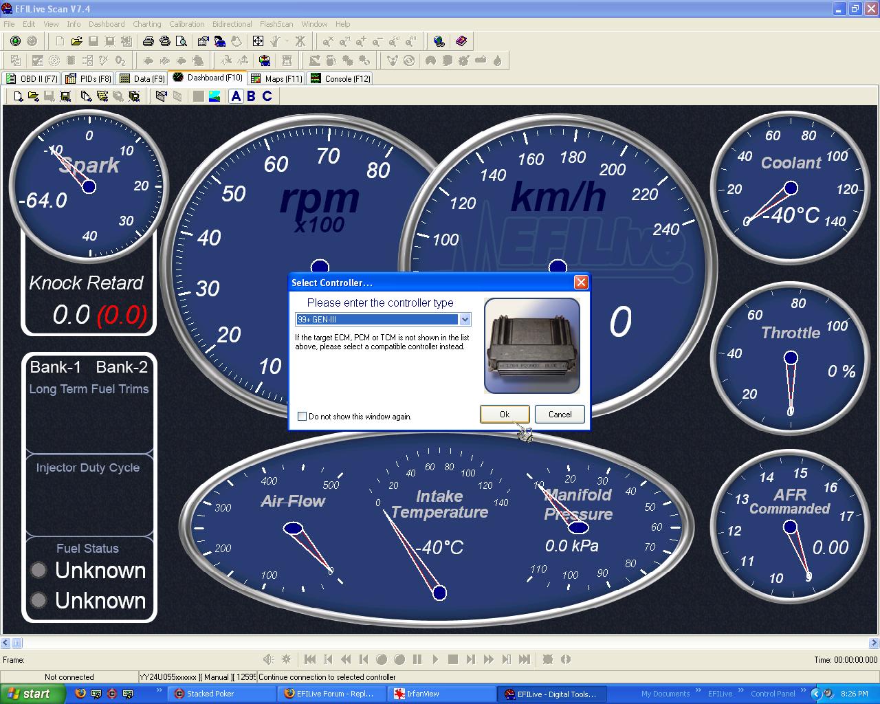

also the scan wants me to select the pcm type each time i connect
even after i check the dont ask again box.
Attachment 1479
That was implemented in the 7.4 release. The check box disables further prompts for the life of the Scan Tool session. When you close and reopen the Scan Tool the question will be prompted again.Quote:
Originally Posted by mr.prick
And it was done for a good reason. We had too many support issues with customers setting it to say LS1, then switching it off. Then next session attempting to connect to some other type of controller and not realising that the software was attempting to connect to an Ls1 controller. So now the user must make the controller choice each time the software is started.
In the next major release (EFILive V8) we are be working on a more "user friendly" approach.

It appears that the calibration maps have been changed from inHg to PSI in one of the latest releases. That has broken the PID link between the scan tool which reports MAP in inHg and the tuning tool maps which now expect MAP in PSI.
The problem is this: the SAE mandate that a scan tool must report MAP (and BARO) as kPa or inHg. Many of our customers have requested that the tuning tool maps be displayed in either kPa or PSI (instead of inHg).
The question now is, do we change the tuning tool maps back to inHg or do we "break" the scan tool and change it to PSI to match the tuning tool?
