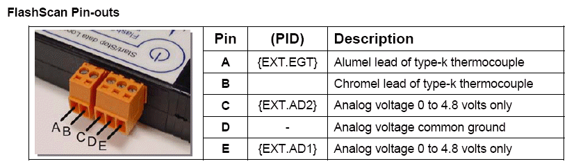

You will probably need to uncheck the "Supported" check box in the [Data(F8)] tab page in order to see your new PID. It also makes it easier to see all your calculated PIDs by selecting (Calculated) in the System drop down list box.
If it has a red (or grey) cross through the icon then it is "not supported" for some reason. You can see the reason by right clicking on it and selecting "More info...".
Usually the reason wil be that you have not selected the required {EXT.AD1} or {EXT.AD2} PID.
If that is the case then choose "External" from the System drop down list box and select the {EXT.AD1} and {EXT.AD2} PIDs (it does not matter if they are both selected).
Then go back to the (Calculated) PIDs and see if the cross has gone from your wide band O2 PID.
The 3 pin plug is for A/D voltages (i.e. wide band input) see image for pin descriptions.

bang it's on However, when I did the cut and past did I do it correctly as far as getting the proper air fuel because it is reading a mesurment of 12.1 at idel here is my file
