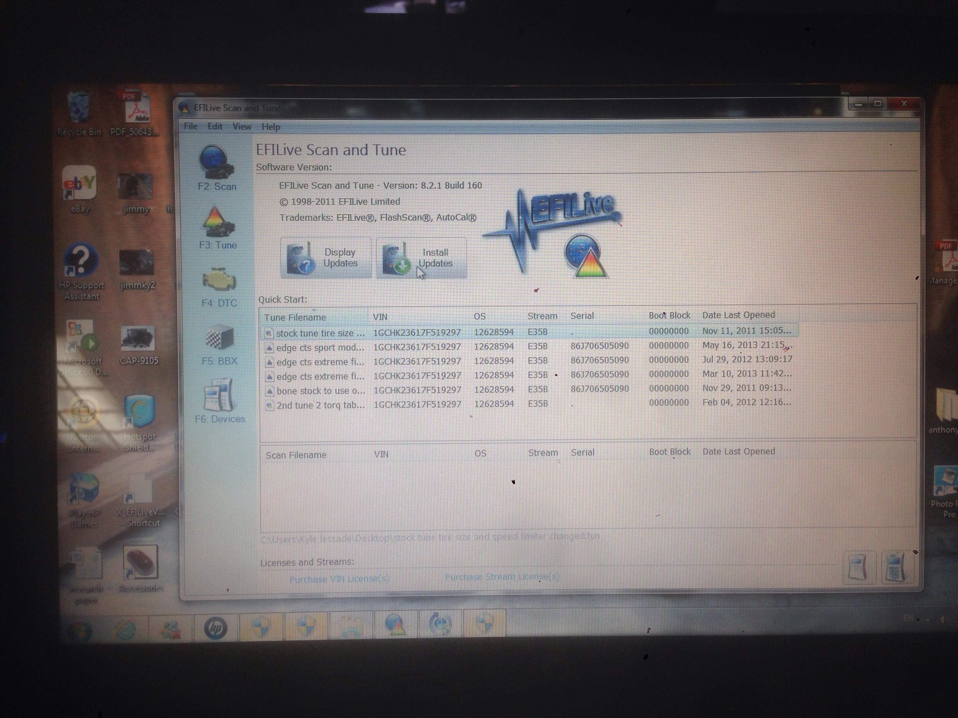

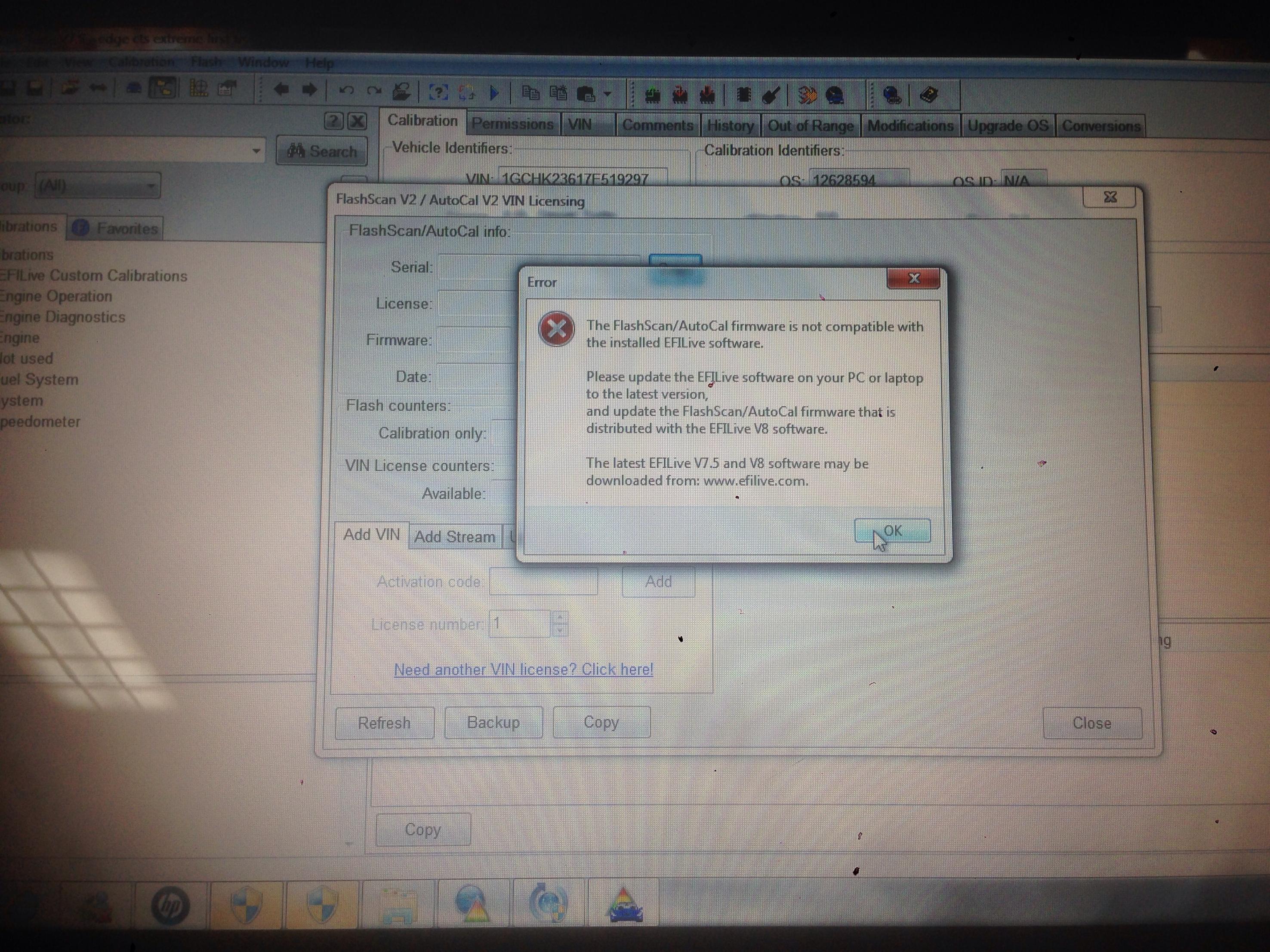

- Connect FlashScan to the PC.
- Run the Tuning Tool Software.
- Select the menu option:
- Help->FlashScan V1 PCM licensing
or
Help->FlashScan V2 VIN licensing
The Authentication code will be updated each time a new PCM/VIN license is added. Actually as noted by some customers, the Authentication code is a rolling code and also changes each time the EFILive software is restarted.
See attached image for example.
