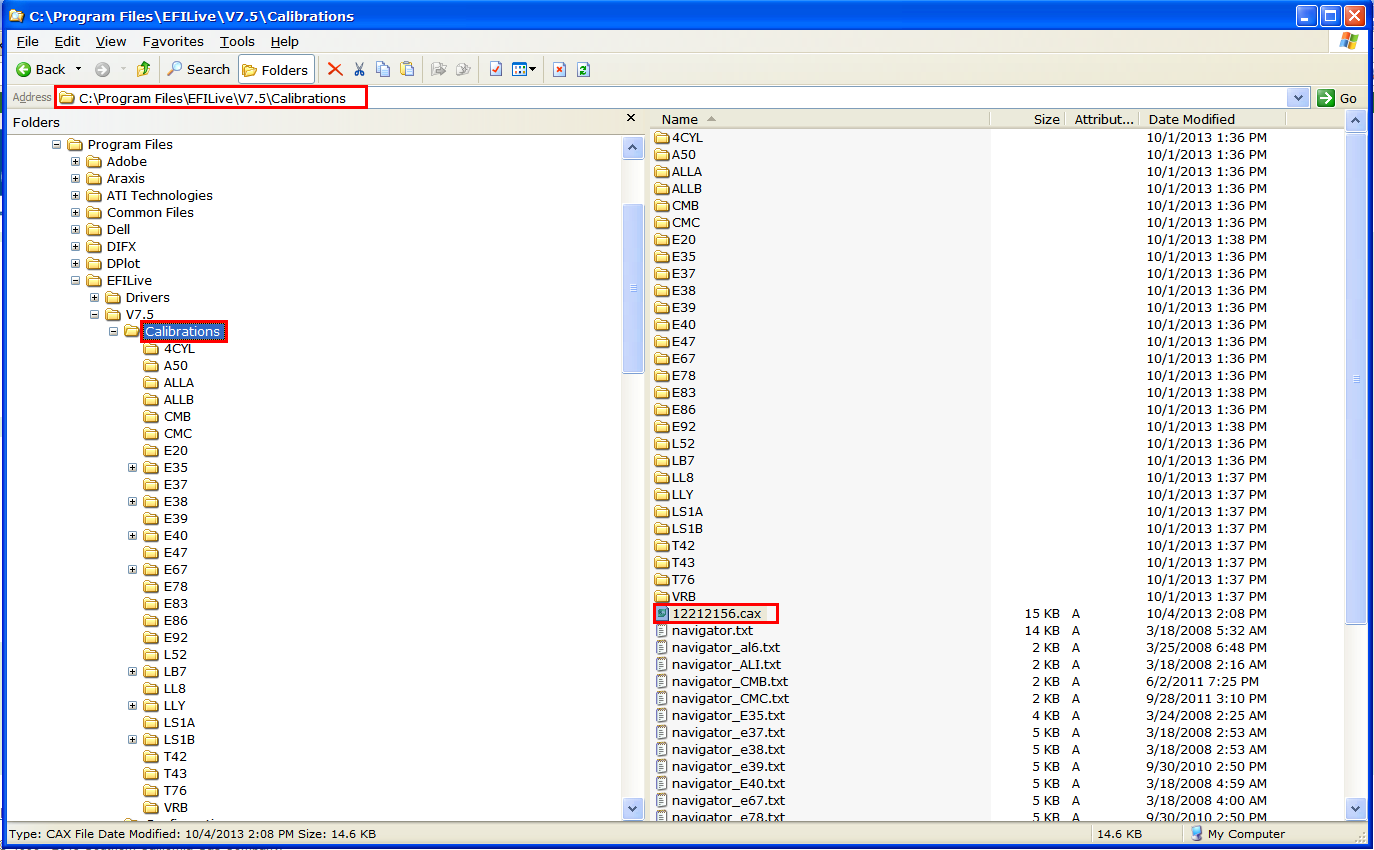

Copy the .cax files for your OS's to the folder C:\Program Files\EFILive\V7.5\Calibrations.
