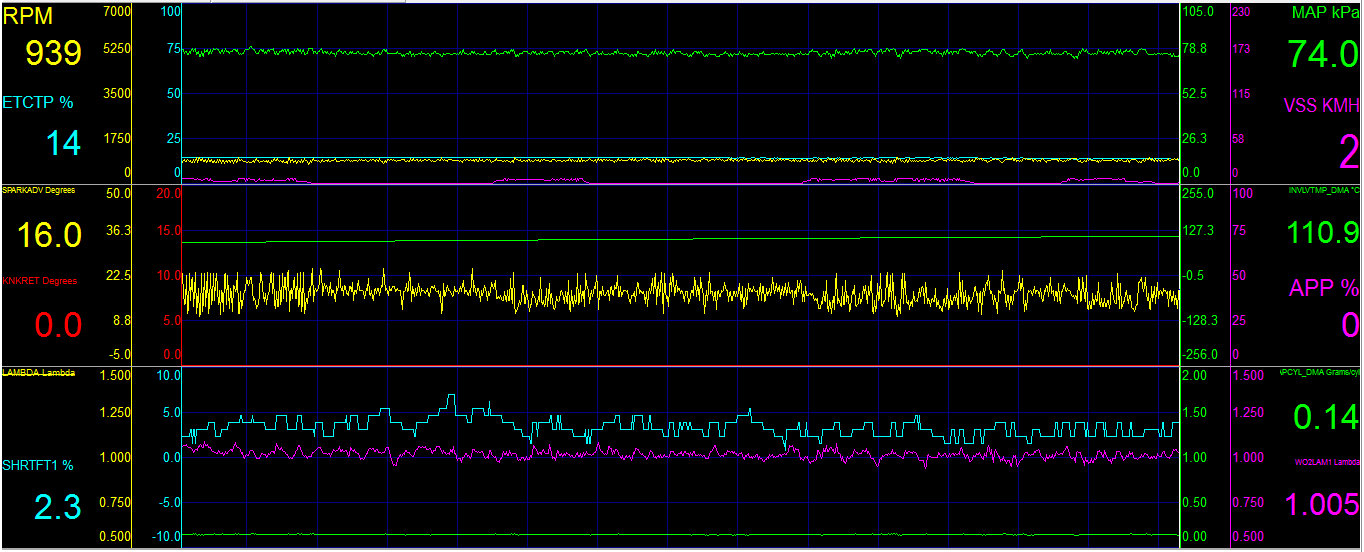

My quick and simple method....
With the FAST 102: Check all components, especially the runners. They have been known to come loose and you will never get it to idle in this case.
With the NW 102mm TB: Just remember that the ECM calculates the effective TB area and uses that to work out how much the TB needs to move for a given gm/Sec correction. With the NW, it is significantly bigger than the 90mm stock unit. {B1650} and/or {B1701} may need adjusting for this TB.
The rest of the idle tables I'd set to stock to begin with and do the following.
- Set idle speed to say 900RPM. Something fast enough to ensure it doesn't stall.
- Set {B1892} up around 9.0gm/Sec, better too much than too little.
- Bring the car up to normal operating temp and let it idle for a bit. Log the idle for a few minutes making sure exhaust airflow gm/Sec, AFR, timing, RPM, MAP, commanded spark and ETCTP are logged.
- Check the log and highlight the idle section, note the average spark timing and compare with the tune setting for idle spark. If the average spark timing is over the tune setting, then you need to add to {B1892}. If the average logged spark timing is under the tune setting, you need to reduce {B1892}. Don't worry about surge etc. yet, just get the average airflow right. Your 15' timing should be OK for this.
- Once the average timing is pretty close (within 0.5' of the tune setting) you can work on any surge.
- With {B1845} I'd zero out all cells from -96rpm to 96rpm, then select the -128RPM row and hit "smooth" a couple of times. Do the same for the 128RPM row.
- Use the Scan Tool DVT's to clear the learnt idle settings.
That's how I normally do it and it seems to work pretty well.
Here's a 408 stroker motor that would be similar to yours. This log it's idling on 900, but it can idle fine on 825.
Attachment 15895
If you get into too much trouble post the tune and I'll have a look.
Simon.
