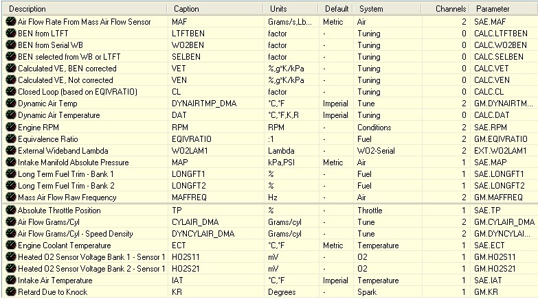

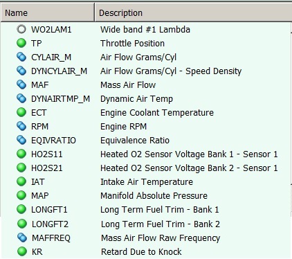

Will V8 trim any PID which is feels does not work for your vehicle? The reason I ask is because I tried to copy 24 and only 17 were pasted.
This is what is suggested to use and I tried to copy
Attachment 18495
And this is what copies over
Attachment 18496
Looks like these are the PIDs which did not copy and I can't find them in V8
Attachment 18497
