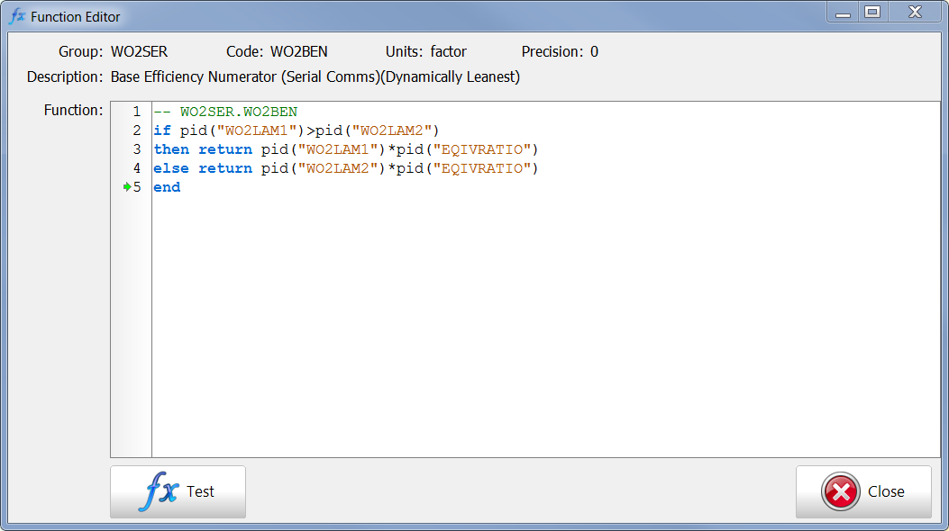

I don't know if this is what you are trying to accomplish, but I just built this in V8. :unsure:
If not totally disregard.
Yes, it is what I want (see mine attached), but I wanted to avoid using an if-then/if-else, I wanted Paul to include a builtin iff() function or operator
(hmmm, operator would be nicer than a function)
Attachment 20560

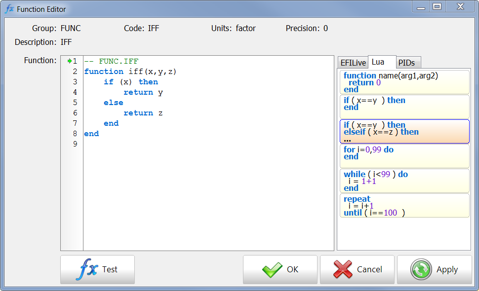

Paul, how do you comment (as in commenting out)...?
It's Pascal/Algol-like:
Attachment 20562

Thanks Paul...
that's what programming is about, working with what is available;
I ended up defining my own, the .ini looks like this now:
Quote:
[Groups]
FUNCTION=Function definitions
WO2SER=Wide Band O2 Sensors (Serial-Comms)
WO2CAN=Wide Band O2 Sensors (CAN-bus)
[FUNCTION]
IFF=IFF,factor,0
[FUNCTION.IFF]
0=|-- FUNCTION.IFF
1=|function iff(x,y,z)
2=|if (x) then return y else return z end
3=|end
[WO2SER]
WO2BEN="Base Efficiency Numerator (Serial-Comms)(Dynamically-Leanest)",factor,3
[WO2SER.WO2BEN]
0=|-- WO2SER.WO2BEN
1=|return iff(pid("WO2LAM1")>pid("WO2LAM2"),pid("WO2LAM1"),p id("WO2LAM2"))*pid("EQIVRATIO")
[WO2CAN]
WO2BEN="Base Efficiency Numerator (CAN-bus)(Dynamically-Leanest)",factor,3
[WO2CAN.WO2BEN]
0=|-- WO2CAN.WO2BEN
1=|return iff(pid("WO2S11")>pid("WO2S21"),pid("WO2S11"),pid( "WO2S21"))/pid("EQ_RAT")
Attachment 20564

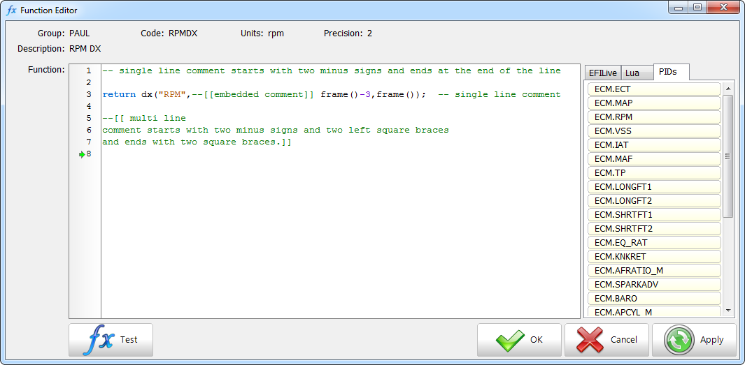

It seems like a pretty arbitrary and strange pair of tokens to use for block comments but it makes including/excluding blocks of code much easier:
--[[ I want to exclude the next two lines
a = b+c
d = e+f
---[[ I want to include the next two lines
a = b+c
d = e+f
Notice that by just adding another minus sign to the --[[ start comment token, it is no longer a valid start comment block, it is just a single line comment, so the two lines of code are now included again.
The end comment token is also ignored because it is now just a single line comment.
