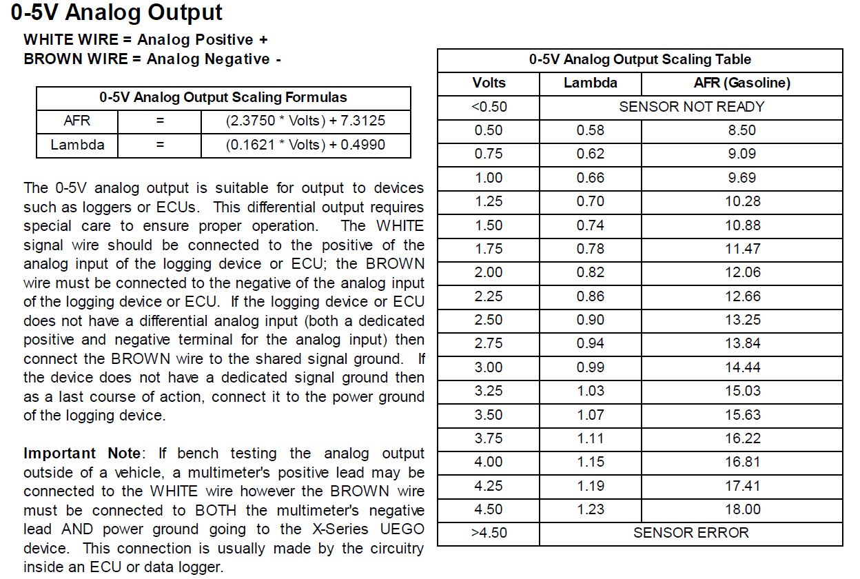

Could I please get some help with syntax,
Why does this work:
V 0.0 5.0 .3 "{EXT.AD1}"
AFR 10.0 20.0 .3 "{EXT.AD1}*2.3750+7.3125"
LAM 0.5 1.5 .3 "(0.1621*{EXT.AD1})+0.4990"
EQR 0.5 1.5 .3 "1/((0.1621*{EXT.AD1})+0.4990)"
But this won't work:
LAM 0.5 1.5 .3 "{CALC.AEM.AFR}/14.7"
EQR 0.5 1.5 .3 "1/CALC.AEM.LAM"
