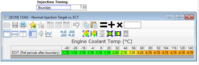

When opening a stock 97C5 tune file in hptuners the boundry value is shown and quite different from later values.
7.22 boundry and 4.78 normal(B3702)
Attachment 22741
Scantool logs pids at 10Hz for LS1A/LS1B/P01 and 40 Hz for E38/E67.
1997/8 LS1's do have various differences compared to later LS1's.
