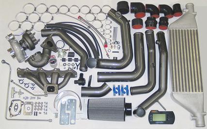

My brother in law has the Pontiac G5 GT with the 2.4L and a GT28 turbo, Holy Crap that car is fast.
He is faster than most of the other turbo cars out there,Cobalt SS,Neon SRT4,Mitsu EVO,Subaru WRX
I wish the P10 wasnt such a weird setup (like the 4cyl PCMs), hybrid SD/alpha-n fueling. GM themselves made a twin turbo I6 using slightly lower compression pistons, oil squirters (03-09 engines already have them), and putting a drop kit and rims on it. Made 400hp/tq, things a BEAST! Wish I could get 15min with that truck, man oh man.
2.4L I4, what PCM/ECM is that? E37? Doesnt surprise me that its faster than a Cobalt SS (s/c, the t/c ones are fast) with an extra 0.4L displacement.
It's an E67, I don't know who tuned it, he had the car before he hooked up with my sister.
Ah that makes it a piece of cake to tune then, know what #s it puts down.
I believe it's 320 FWHP Like I said STUPID fast.
He has a complete kit from Garrett (since been discontinued:bad:)
GMPP intake with 80mm throttle body, GMPP H-beam rods, GMPP billet crank,
JE Pistons, CNC Head with O-ring head gasket, Performance clutch.
(I called him just to make sure)
He has more money into it than he paid for it, BUT he's made most of
it back at street races. NOBODY sees it coming.
http://www.atpturbo.com/mm5/graphics...ob-002-475.jpg
http://paceperformance.com/images/M20095740.gif
