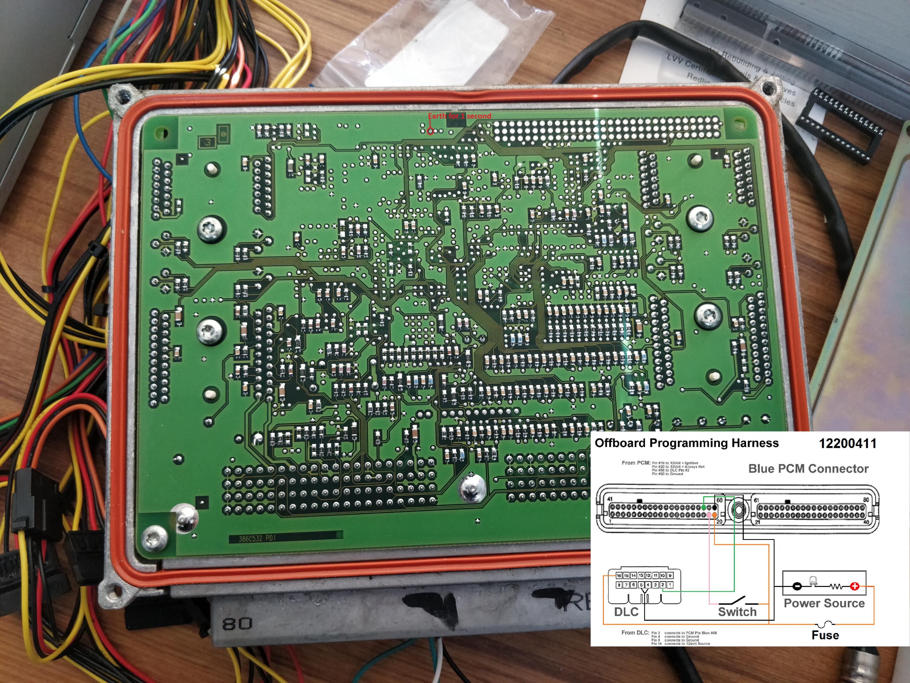

So I got a ECU and to my supprise when trying to read it I got a $0537 error.
At first I tried the brute force method but 3 days in something went wrong with the software and it stopped its self before finishing.
Not wanting to start over again and because the ECU was basically junk other wise I tried the method shown in the video and it worked with out letting the smoke out.
Here are the instructions.
Attachment 22864
Earth the pin point I have marked in red at the top of the image for 1 second as you power the ECU On.
You have about 10 seconds before the ECU will respond that its in recovery mode.
