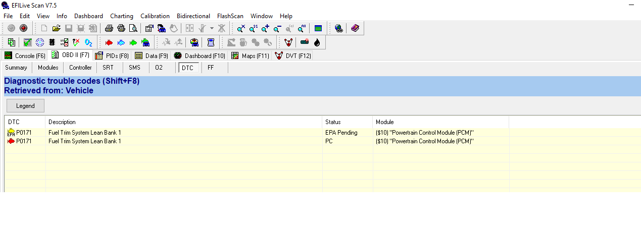

When I go towards WOT, the car just goes SUPER rich and throws a check engine for "lean bank 1" (See attached)

I was able to find stock files in the "other" software. I did a compare and it looks like the person who "tuned" this car once before barely touched any part of the file. I see that the needed VATS and CHECK ENGINE light DTC's were disabled for the mods. I see some timing and fuel added. PE tables were touched. But that's about it.
If you watch the datalog, you'll see that the 02 is throwing in a BUNCH of fuel like it's going into some sort of "Limp Mode". My wideband does show the event, so it's confirmed.
