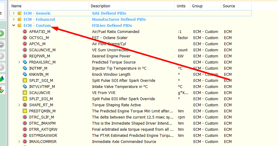

I've been meaning to release this for a while. I hope everyone finds this useful and this might be a good addition to everyone's scanner. This has most parameters I typically use that are not defined within EFILive. You can find these parameters by going into the ECM Custom area Make sure to validate the PIDs. If there is one that is really important let me know and I may attempt to add it.
Attachment 24528
Drop these into: C:\Users\<YOUR USERNAME>\Documents\EFILive\V8\User Defined PIDs\pmm
