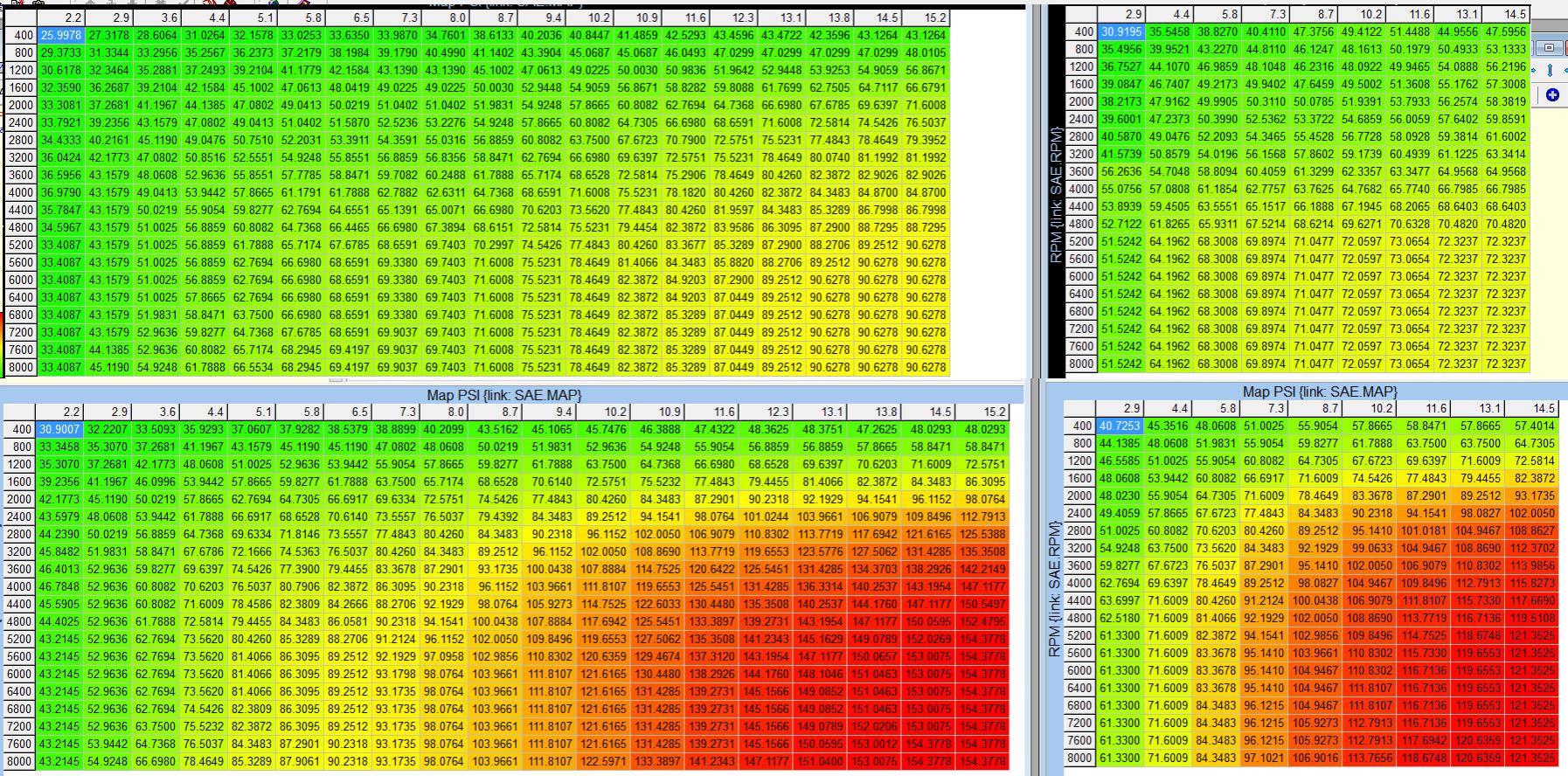

When I Read (with EFILive) the tune with my V2 that he has started (not yet complete ... still more tuning to do) in EFILive, I see the same size table, just the values have the same spread ... Like there is less resolution to the table I see in EFILive vs what he showed me in HPTuners.

I'll screen shot the VE tables from that tune, and from the previous tune so you see what I see. But, instead of more rows like I saw in the HPTuner software, I see larger numbers ... but, not the same resolution/# of cells.
