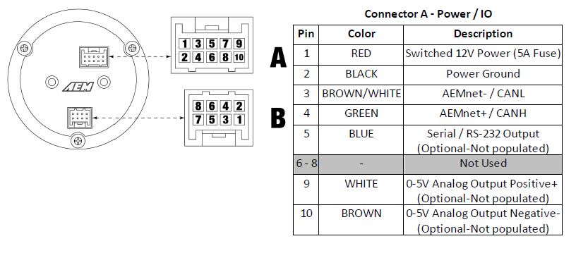

I'm getting started back up after a few years out of the game. I got a new AEM x-series wideband installed last week. I used to tune with an LC-1 but it died a few years ago. The new wideband is working but I can't get the V2 to see the sensor. I believe I have it wired correctly, I have verified that my ground and signal output go to pins 5&1 respectively on the Flashscan V2 RJ-11. The V2's 2nd light (serial coms) doesn't light up. I figured out how to cycle through different wideband options on the V2 by pushing the backspace button. The wideband doesn't show up on any of them. I've been out of the game too long, is there something else I have to do to the V2?
I wanted to start a new thread because the other one is focused on CAN communications. Working on an LS1B controller here. I feel old since everyone is playing with the new stuff now :ermm:
*Full disclosure*
I originally bought the 30-0333 kit but should have bought the 30-0300. I depinned AEM's 3&4 pin and reused one of the pins for my serial out (pin 5). I'm pretty certain I didn't mess that up... but you never know...
Attachment 20734
