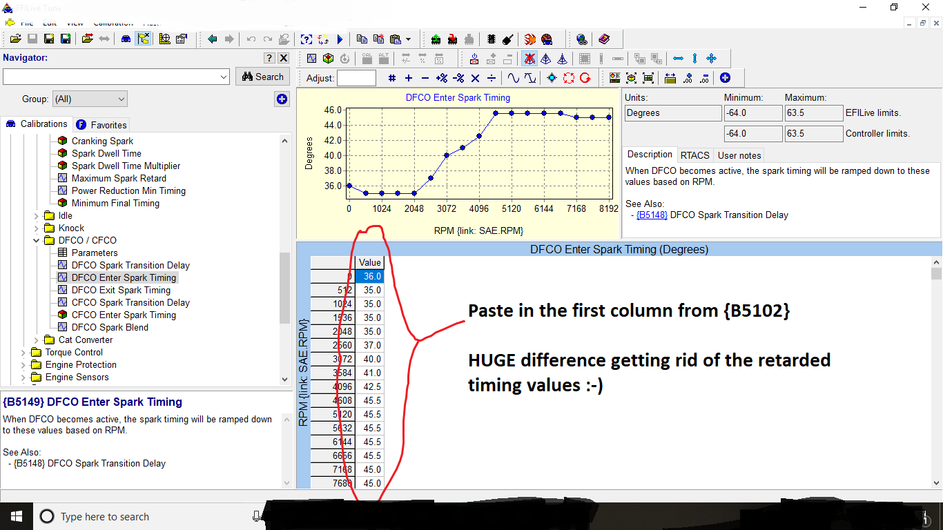

To stop the "popping" on the entry / exit of DFCO, simple set the timing values in {B5149} and {B5150} to something like 10'. The exhaust backfires occur when the timing drops to very low values and unburnt fuel is ejected into the hot exhaust, where is ignites as an uncontrolled burn.

I wanted to add a bit of input here as I have been trying to fix a tune on a 2010 Camaro LS3 with long tubes and fairly open exhaust. The thing crackles and pops very badly upon decel until the DFCO kicks in.
My fix in the end that is almost perfect was to copy the values in the first column of the low octane timing table {B5102} over 2 {B5149} and {B5150} as both those values are set to VERY retarded timing.
The car is 100% better and people on the street aren't staring at me any longer from the obnoxious noise.
Hope this helps someone struggling like me!
Attachment 22923
