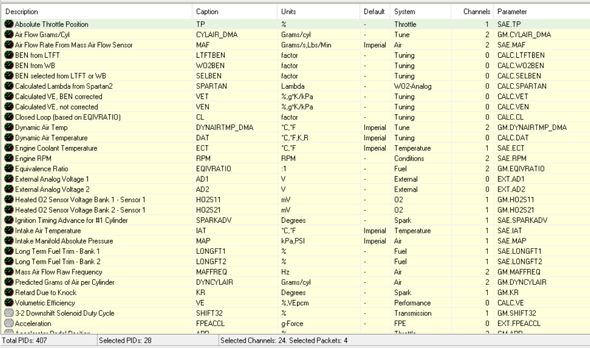

Seeing as the CALC.VET (MAFT) tutorials are going on 10 years old, is there an updated *suggested* list of PIDs to log ?
I am currently set up as follows for a P59 pcm:
Attachment 23003
