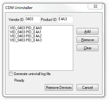

- Enter the following values: Vendor ID: 0403 and Product ID: E4A0, then click [Add].
- Do the same for Product IDs: E4A1, E4A2 and E4A3, clicking add after each one.
You should end up with a display like this:
Attachment 15329 - Click [Remove Devices], the removal process should be complete after about 10-20 seconds.

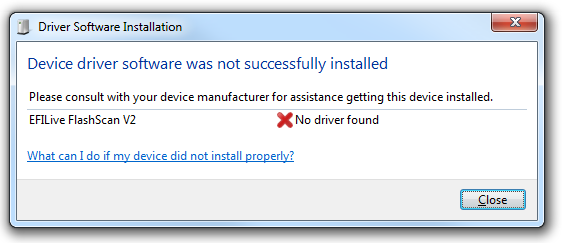

- If a balloon appears in the system tray saying installing or searching for drivers, click on it and then click on the option "Skip obtaining driver software from Windows Update".
- You should see a message similar to this:
Attachment 15330

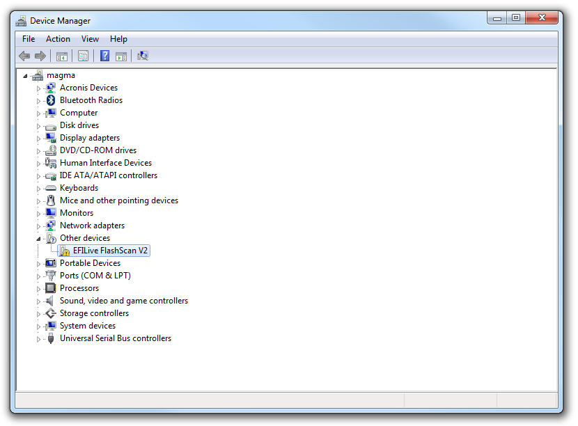

Click [Close] to close the error dialog box. - Start Windows Device Manager: Hold down the Windows key and press and release the Pause key, then select Device Manager.
- Locate the device you connected (FlashScan or AutoCal) in the list of devices, most likely it will be shown with a little yellow tag indicating that the drivers are not loaded.

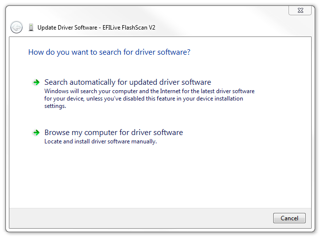

Attachment 15331 - Right click on the device and select "Update Driver Software..."
- Select "Browse my computer for driver software"

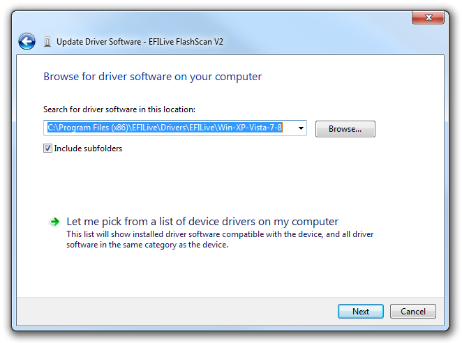

Attachment 15334 - Navigate to the folder containing the latest drivers which will usually be
C:\Program Files\EFILive\Drivers\EFILive\Win-XP-Vista-7-8(on 32 bit machines)
or
C:\Program Files (x86)\EFILive\Drivers\EFILive\Win-XP-Vista-7-8 (on 64 bit machines)

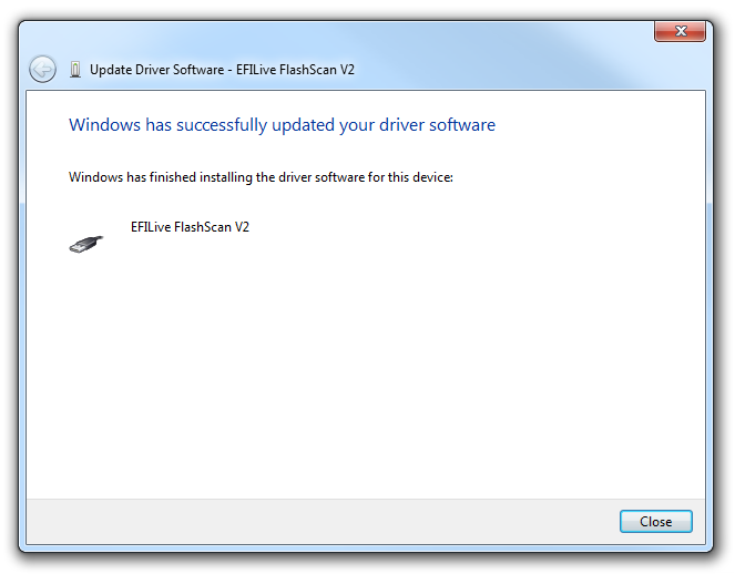

Attachment 15333 - Click [Next] and the drivers will be installed.
Attachment 15332
