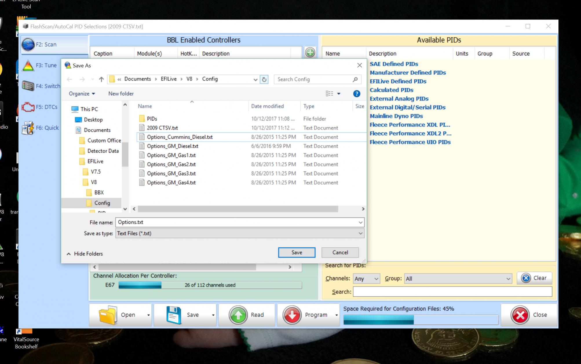

My tunes work fine, its data logging I'm having trouble with. When I select pid list and press 0/power I get the error message. After adding my controller I made my pid list, validated it and saved in in the predetermined destination as 2009CTSV.txt. Weird it will let me do live display of my pid list but not log it.
Attachment 21606Attachment 21607

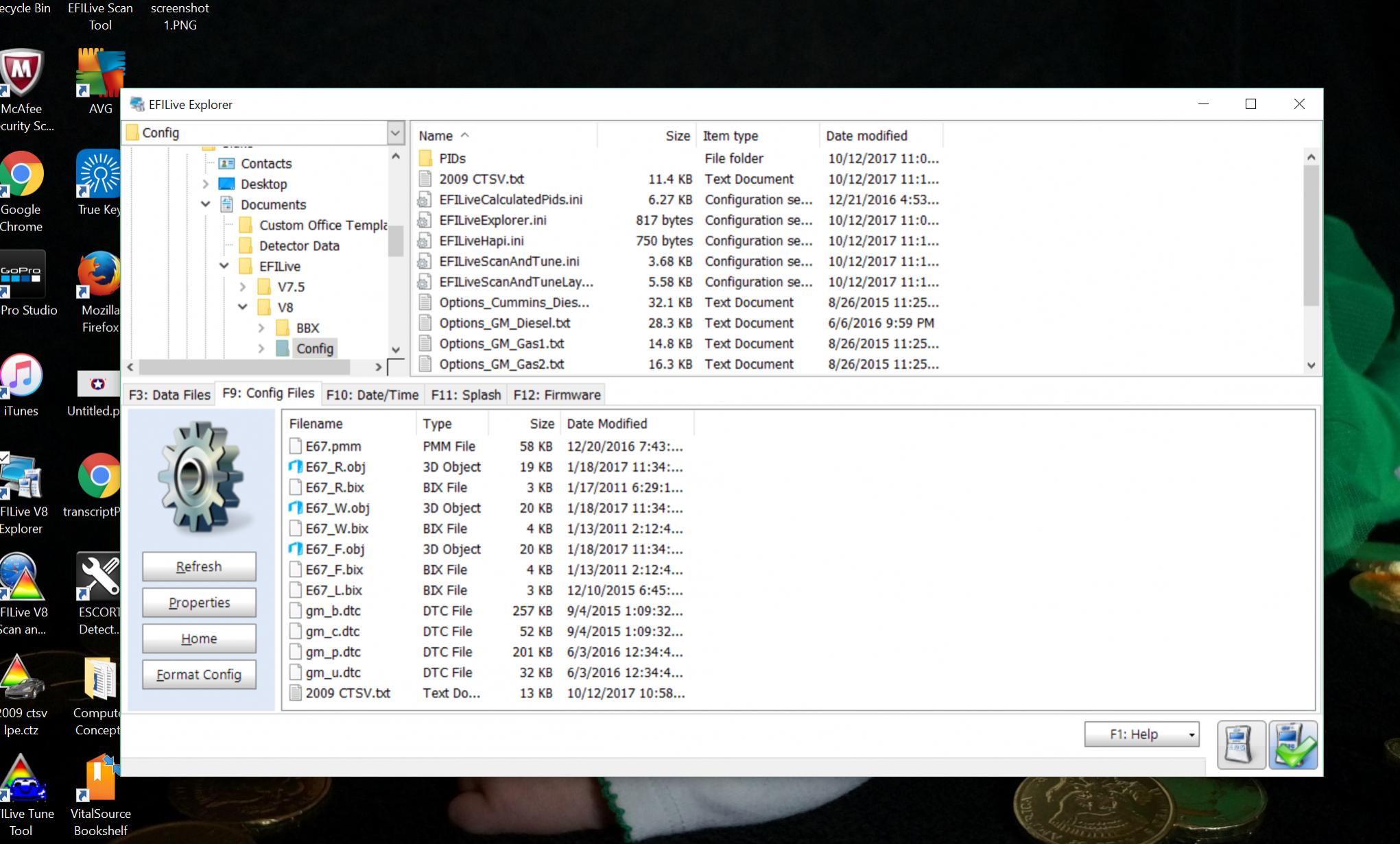

Using EFILive Explorer, show the F3 Data Files tab, and post a screenshot of that...
I think there might be a folder missing.
You were right I didn't even notice, the Scan folder was missing. No clue how that happened, thank you. This is why you're awesome.
