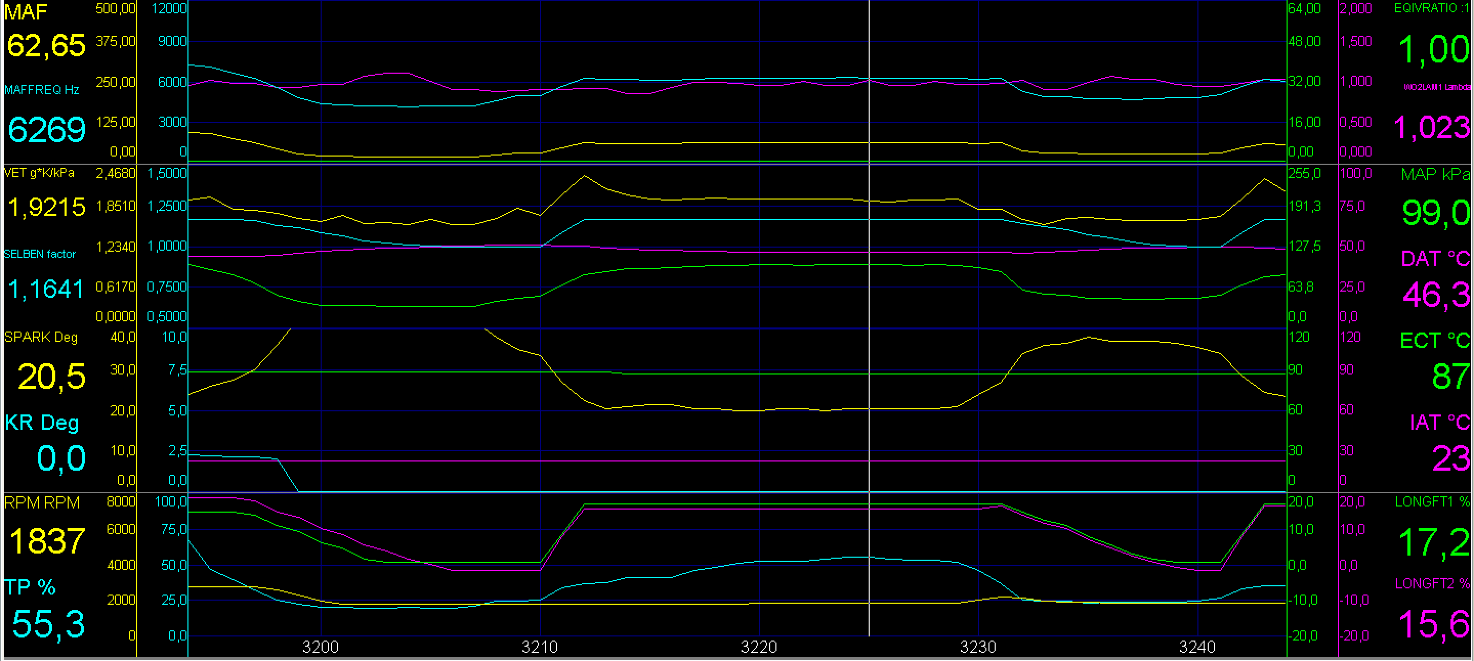

But in my log Lambda averaged at 1.002. Does this indicate that E10 isn't actually 10%?Attachment 20997
Yes, correct.
I'm told that alcohol content in gasoline can be +/-8%... i.e. your E10 can be close to plain gasoline.
