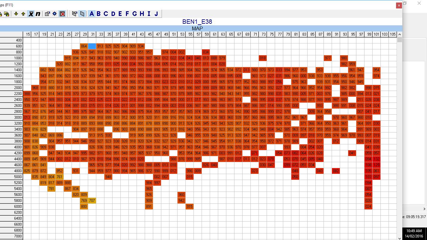

Yep there isn't any crazy steps in it, if it's not my VVE then where should I be looking to get my idle AFR back closer to the commanded? Or is it a case of leaving it since it idles happily at these numbers.
I'm not sure what I'm doing wrong but I cant seem to get this VVE process working. it either causes huge peaks in areas and huge dips in others unless I use the copy and fill process, but when I use that it seems to change my logged data to much and don't get the desired effect in AFR? I have tried to attached a log but it wont so here is the latest tune file after applying this BEN Map.
Attachment 19253
Attachment 19254
Found my problem, if you set map precision to 3 any numbers over 1 become .025 ect if it's set to 2 the number shows 1.02. So every time I would paste and multiply it would cause issues. In the mean time any rich spots have been sorted but all the lean spots never changed as they would multiply by .025 cause a huge hole then get smoothed out once I would gem coefficient and vve
