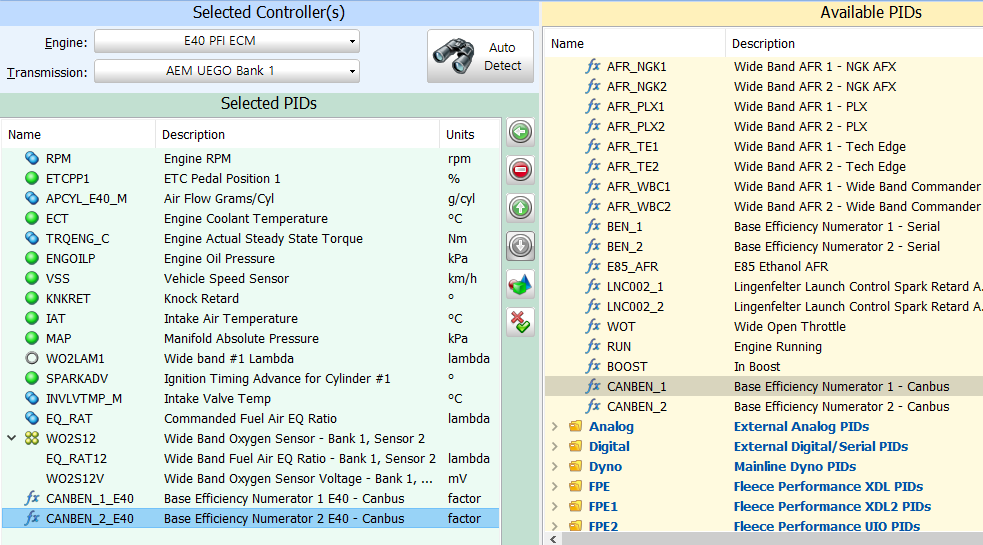

CANBEN_1="Base Efficiency Numerator 1 - Canbus",factor,3
CANBEN_2="Base Efficiency Numerator 2 - Canbus",factor,3
CANBEN_1_E40="Base Efficiency Numerator 1 E40 - Canbus",factor,3
CANBEN_2_E40="Base Efficiency Numerator 2 E40 - Canbus",factor,3

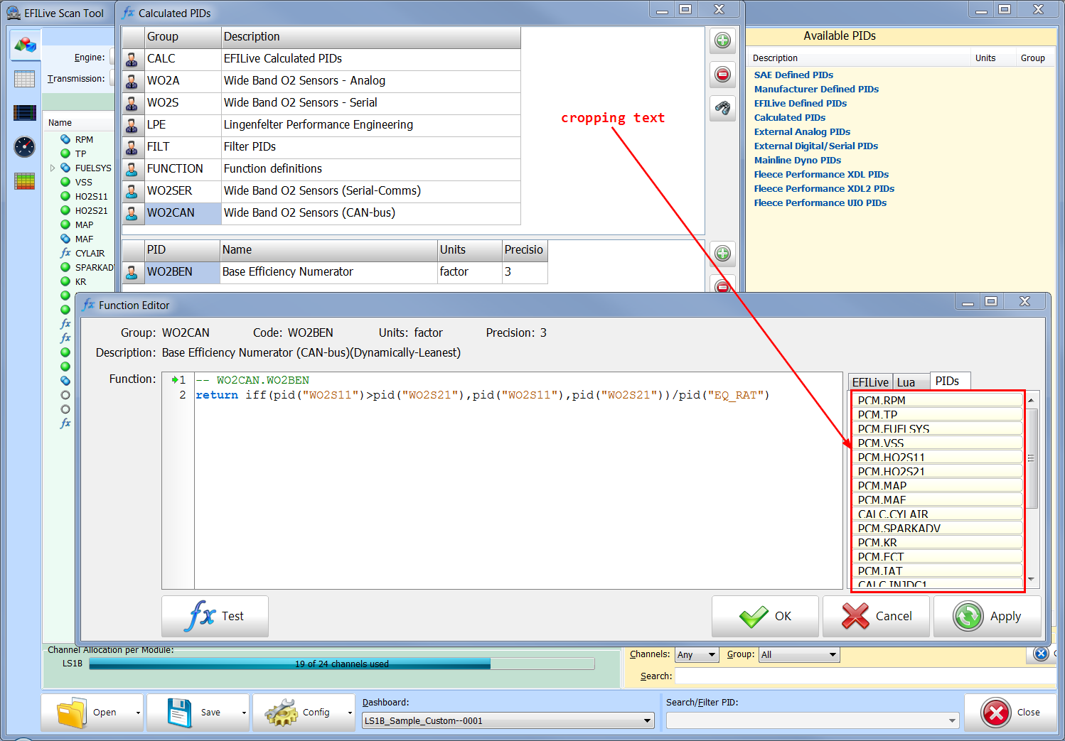

factor 0.5 1.5 .3 "{EXT.WO2LAM1}/{SAE.LAMBDA}"
Now looking at the above and some of the efilive defined pids, I'm actually thinking it might be possible to setup/define something like below to have all the CAN wb's.
[WO2CAN.BEN_1]
0=|-- WO2CAN.BEN_1
1=|return pid("WO2S11,WO2S12,WO2S21,WO2S22")/pid("EQ_RAT")
