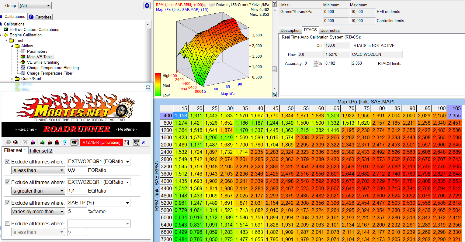

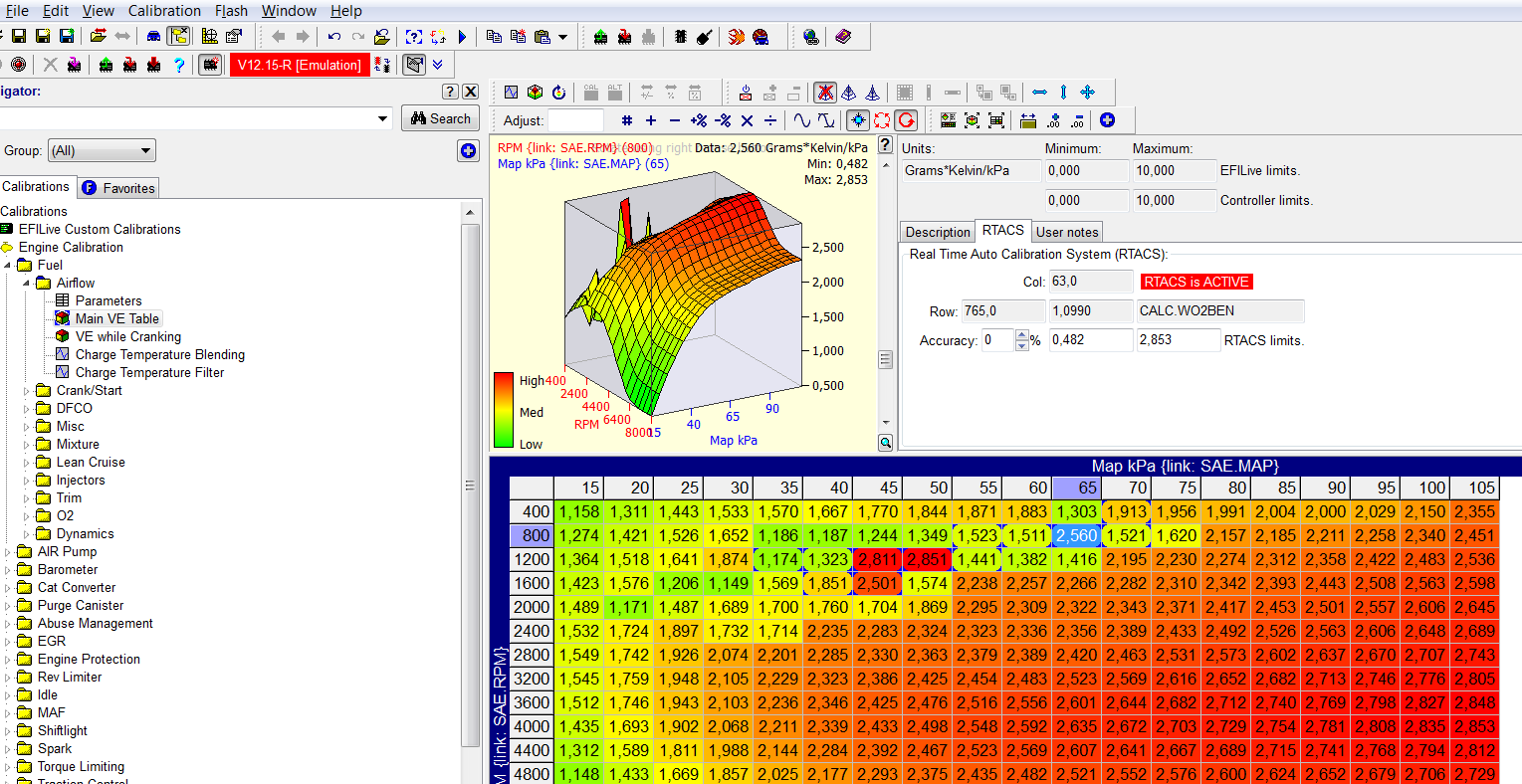

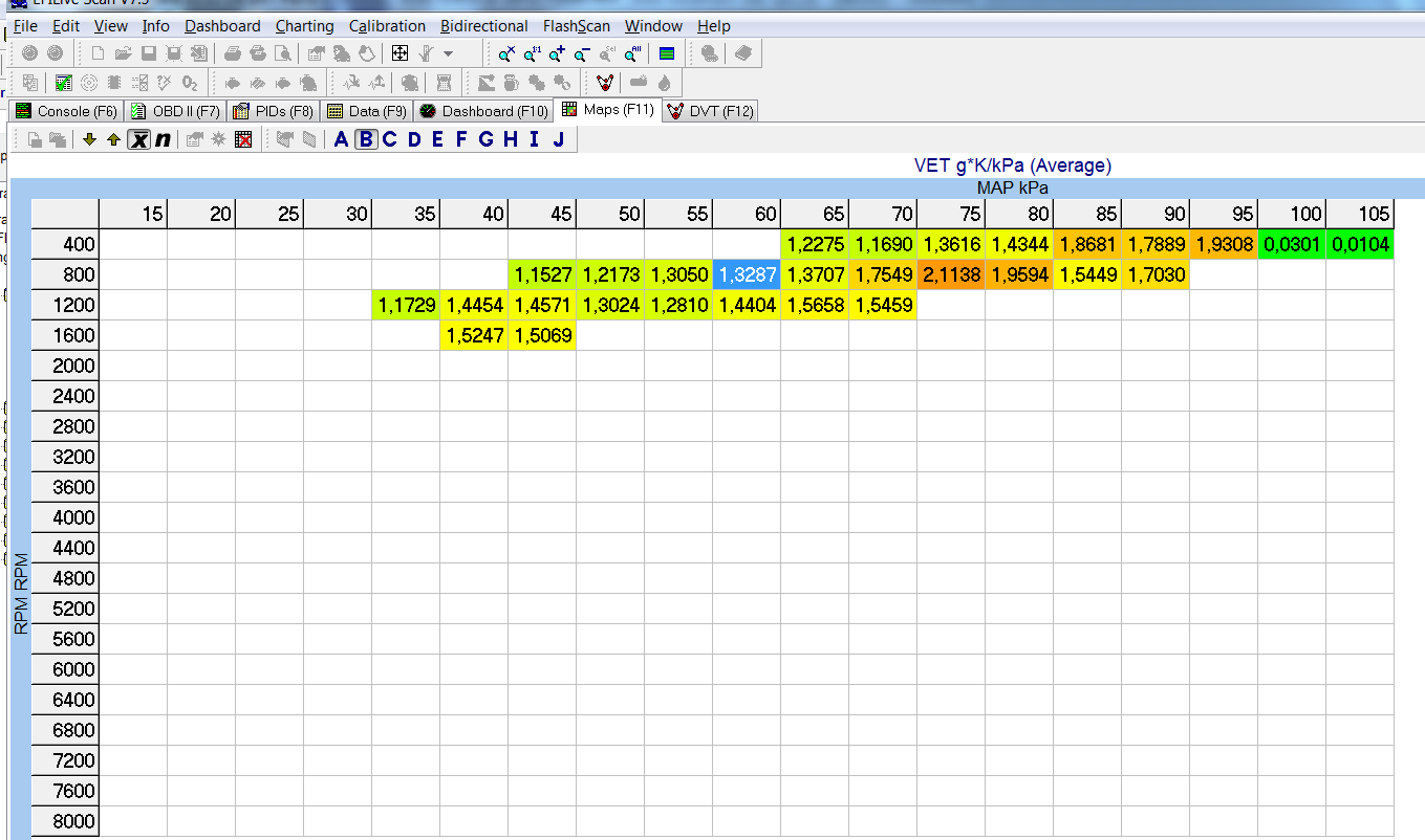

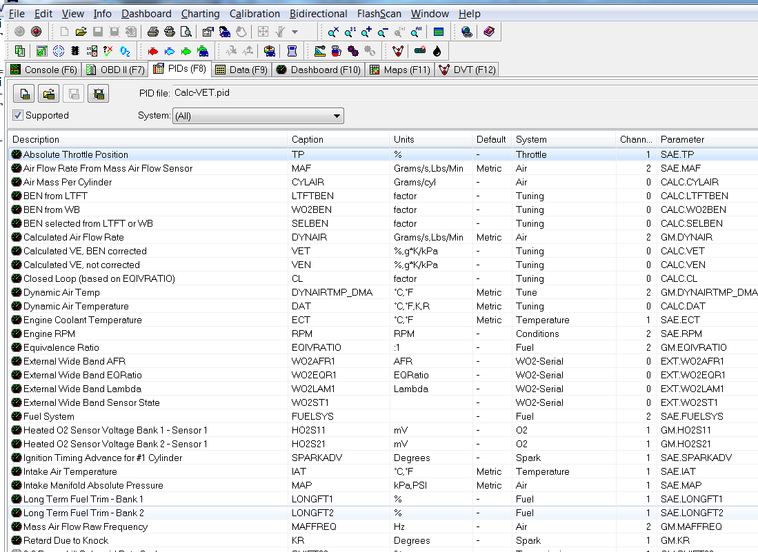

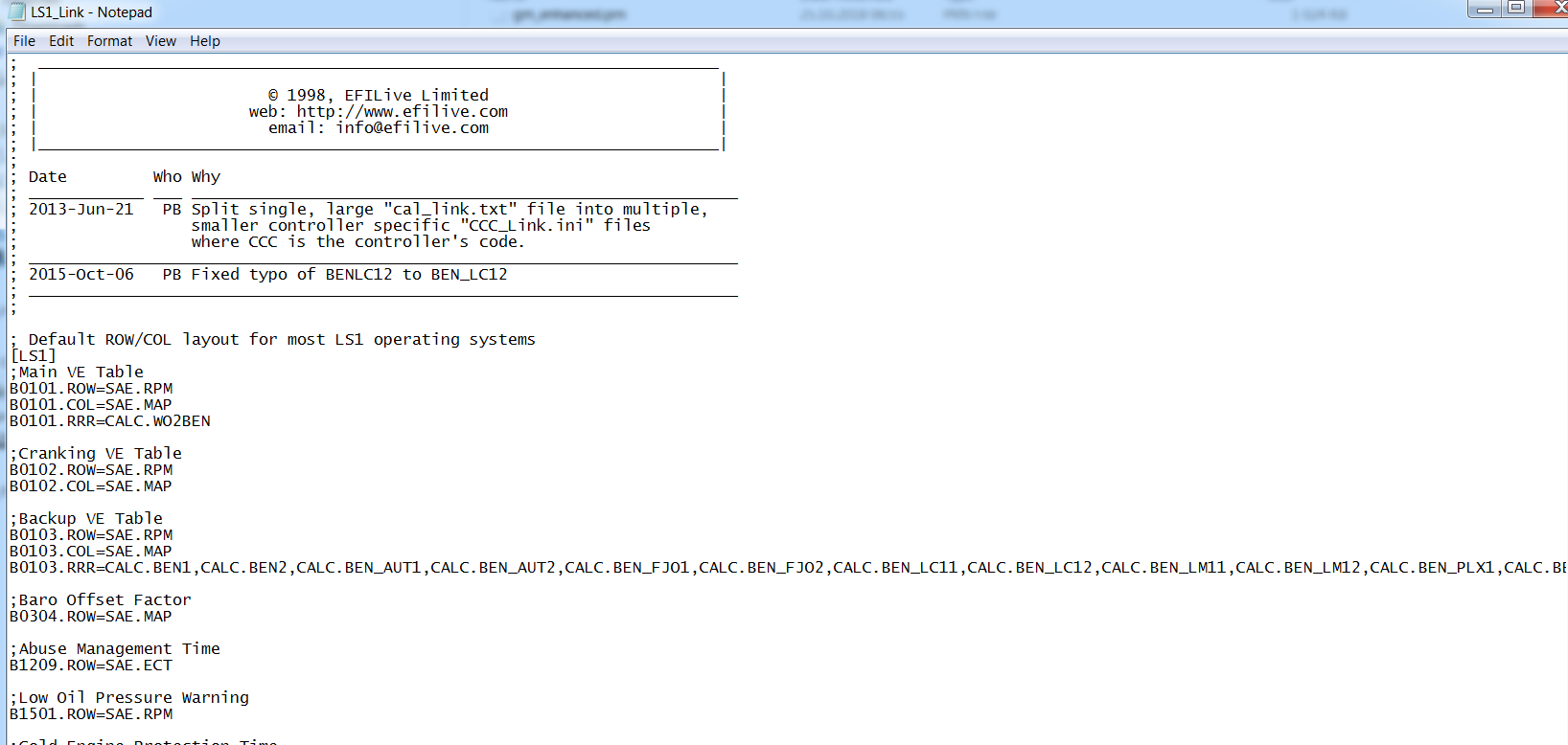

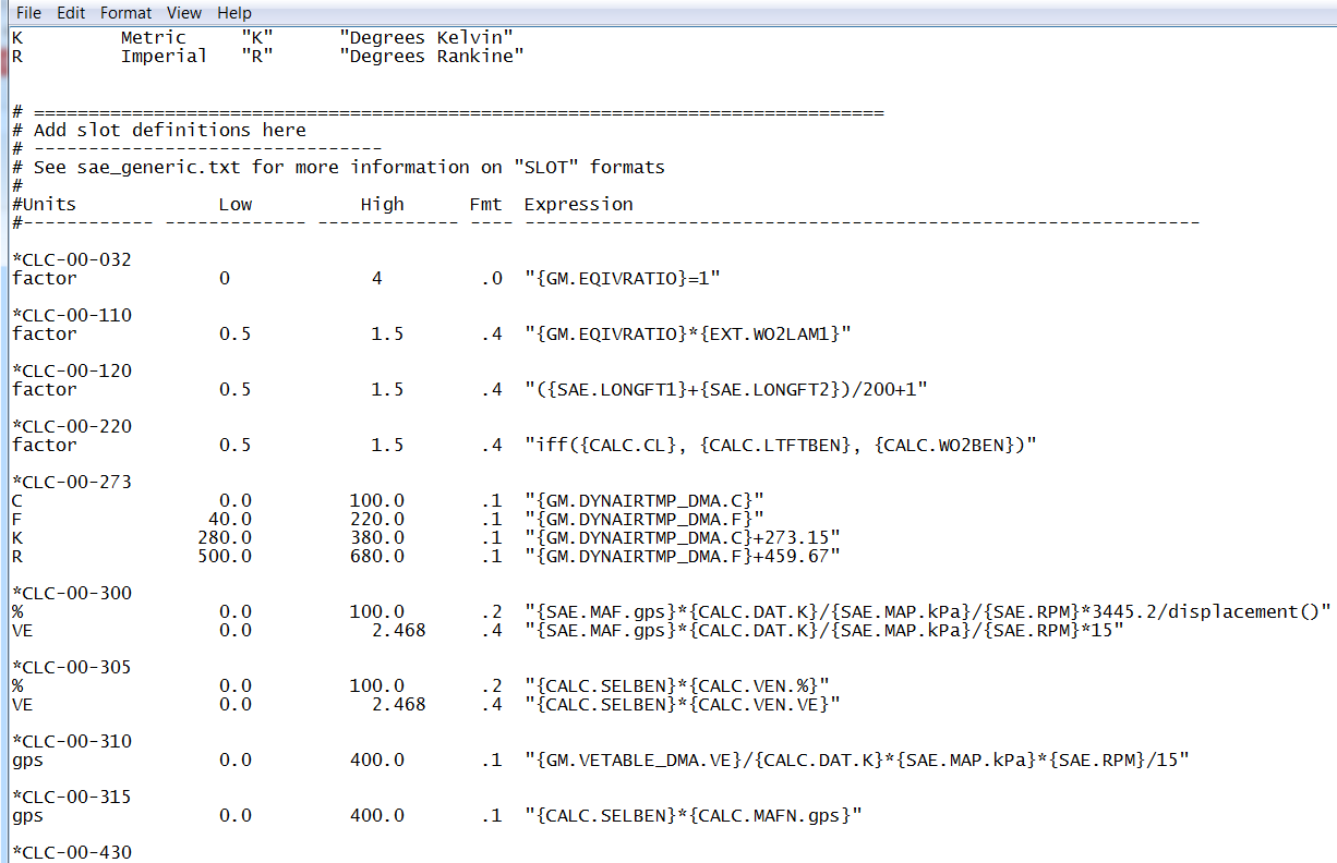

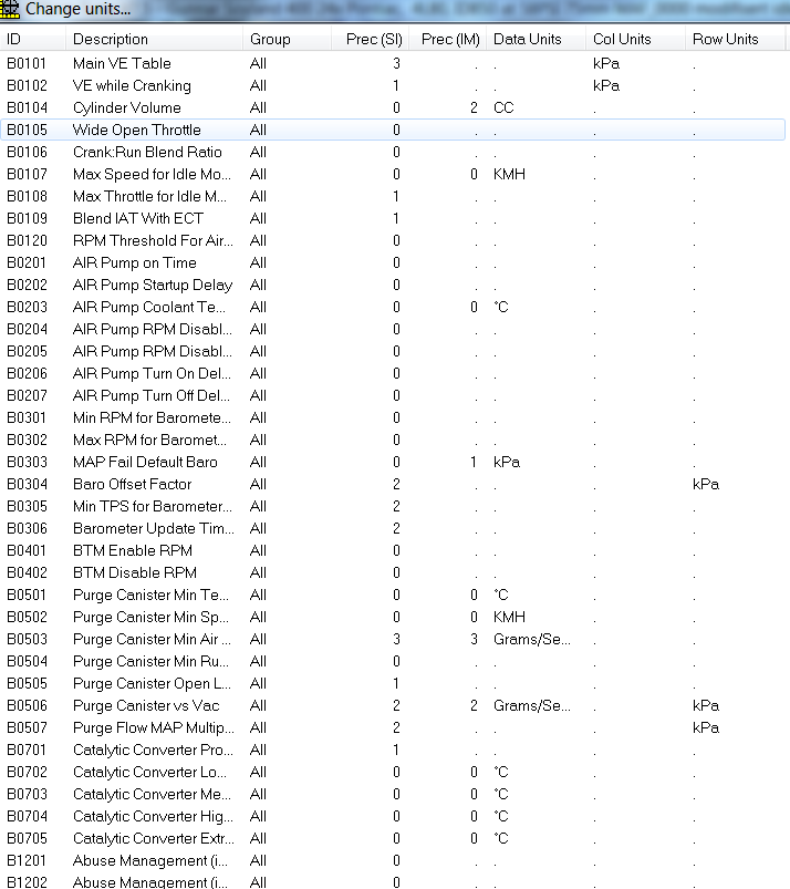

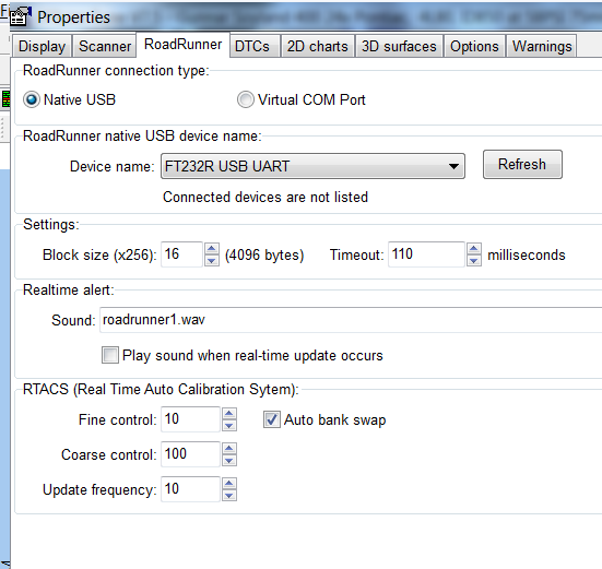

have only had the engine running have not driven it, tried on the last log (the picture are from) to switched from CALC.BEN1 to CALC.WO2BEN (same result).
Attachment 22560Attachment 22561Attachment 22562Attachment 22563Attachment 22564Attachment 22565Attachment 22566Attachment 22567Attachment 22568

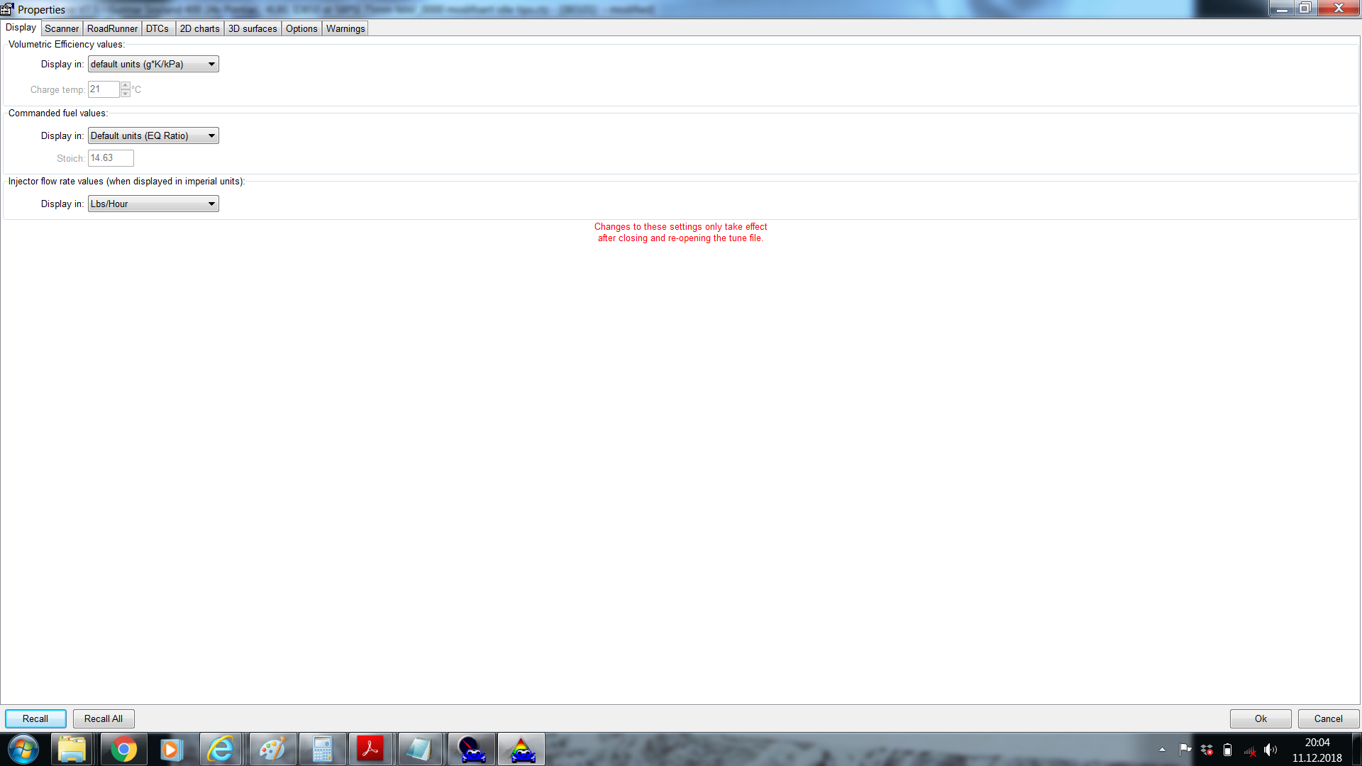

Is your tune scaled for MAF or IFR...?
What injectors do you have...?
Is your tune scaled for MAF or IFR...? I dont know, where can i check it .

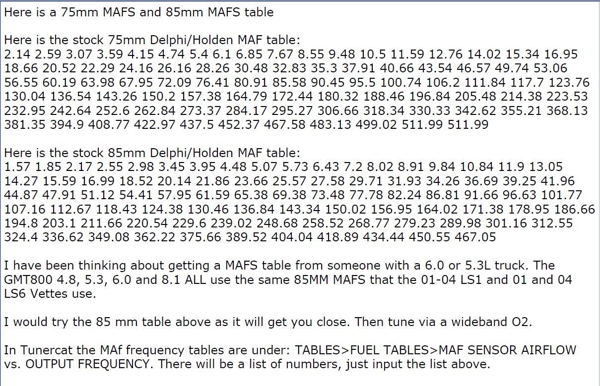

MAF is 75 mm with std GM data
