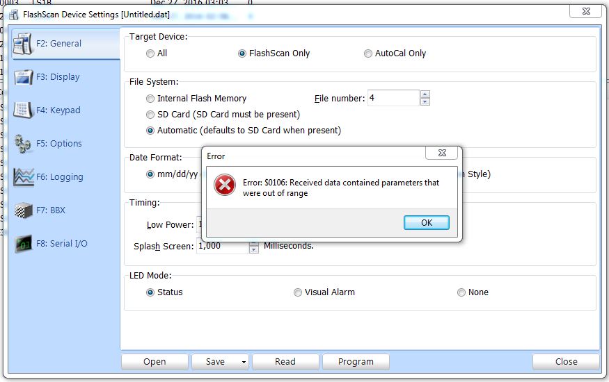

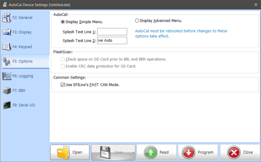

With the v2.07.108 firmware I'm having an issue editing AutoCal splash text lines... Text 1 is empty and Text 2 reads "ive Auto". When I try to save new text values I get, "Error $0106: Received data contained parameters that were out of range.".
Attachment 20579

Same issue here.
Attachment 20580
Software updates for V7, V8 and firmware are now available to fix the Cummins recovery issue and Error $0106.
Customers running the December public release can use the Check for updates options. I'll update the software links in this thread tomorrow. Updates Links are on our website.

Awesome, thank you. Tested and no more $0106
