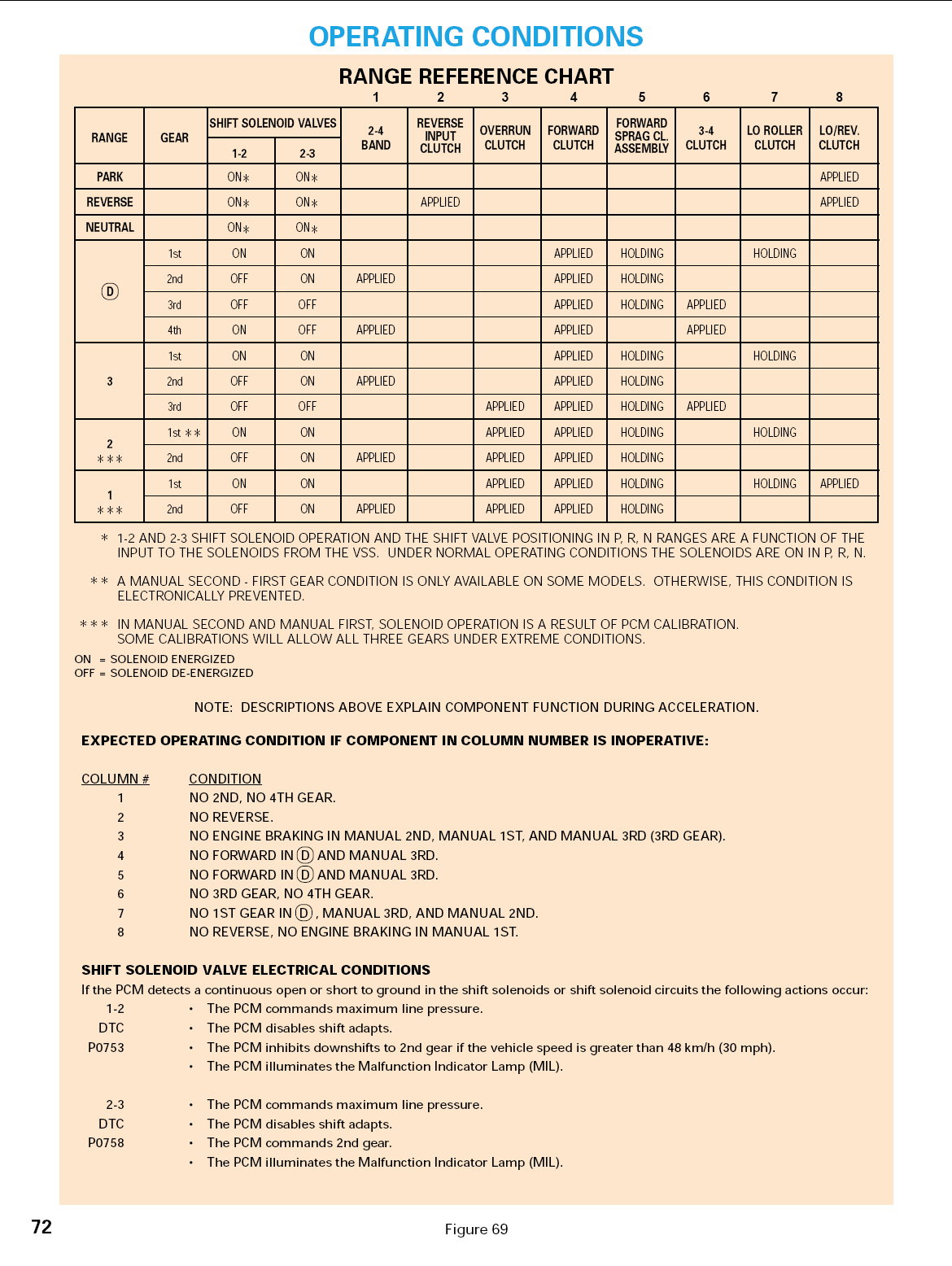

Hi fm-usa,
Welcome to the forum...:cheers:
I couldn't answer your questions with certainty...
but here's the transmission wire diagrams for the two vans, the wires/pins appear to be the same, so my guess is they are interchangeable.
Yes, 4L60E suffering no 3rd or 4th typically is 3/4 clutch failure.
With the deep pan you have to get the correct filter.
(if others have more info please respond)

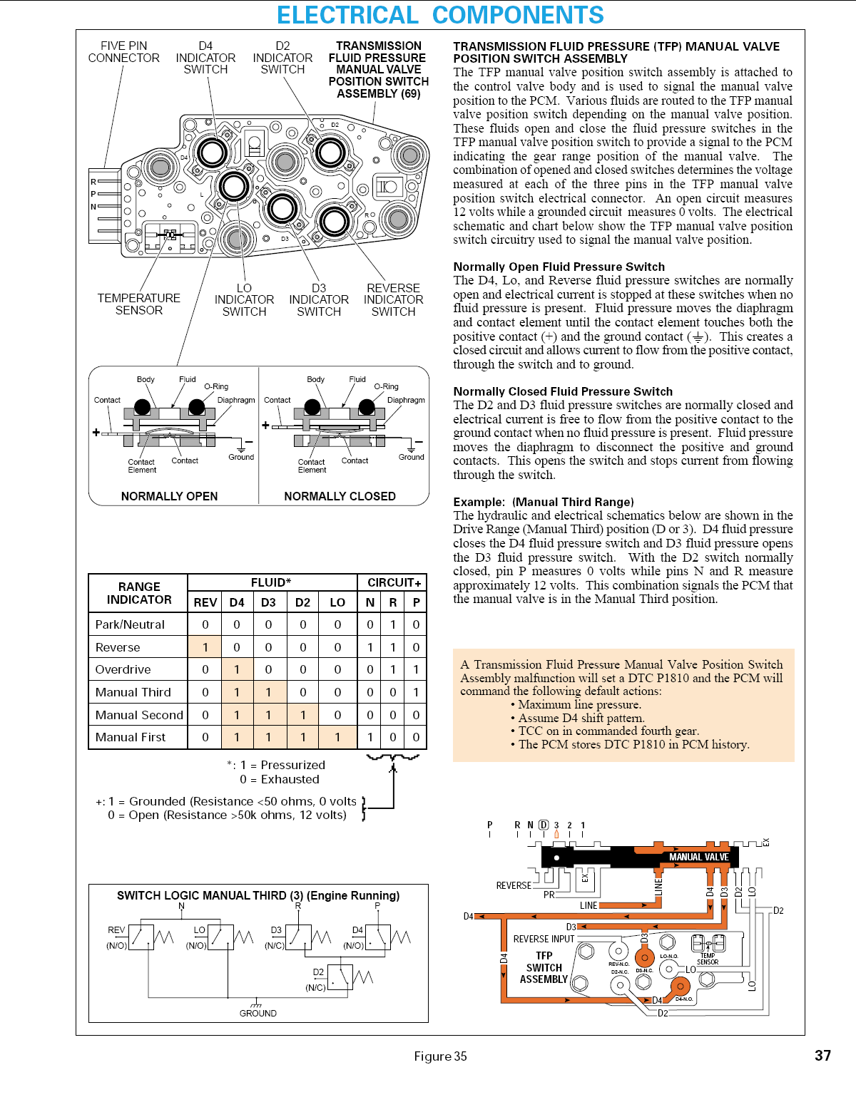

Here's a little more that might or might not help some others with problems: Circuit 1020 in S-Series (Blazer, Jimmy, Bravada, S-10, Sonoma) controls tranny functions, and is subject to failure because of a switch in the steering column connector harness. Many transmissions have been rebuilt because of this failed $80 switch.
Failure of this circuit can make the tranny default to limp mode, 3rd gear only, and can trip the tranny fluid pressure controller to max, which will make the tranny detonate in a week if not fixed, or at least re-set in the computer for temporary fix.
