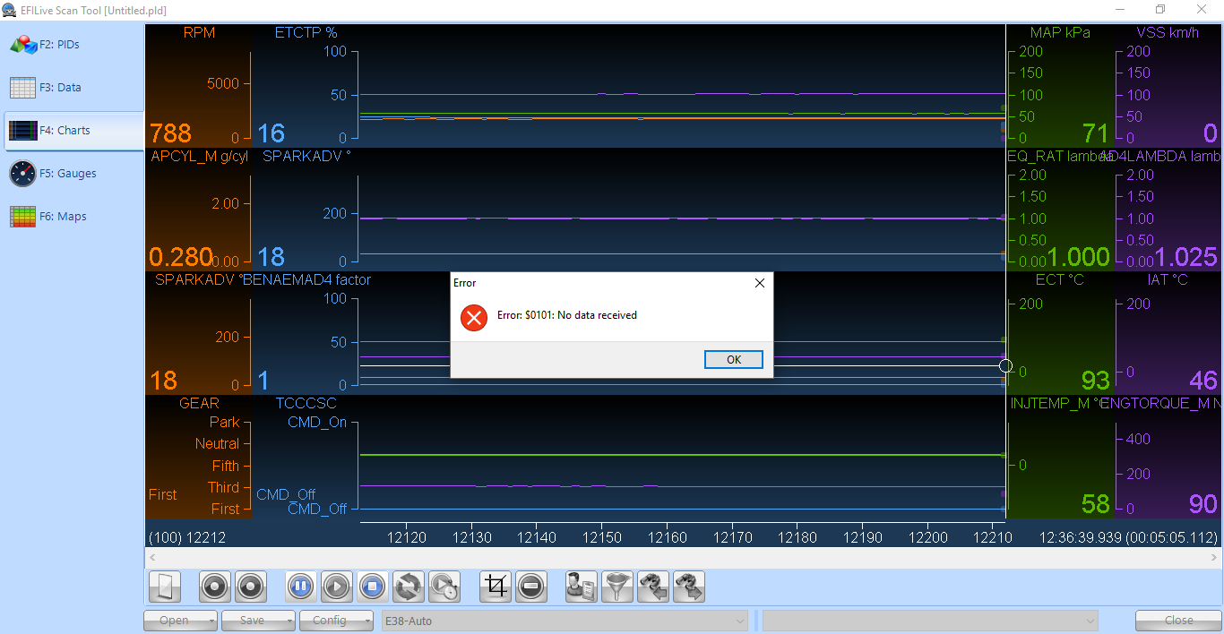

Have the following setup for the aem analog ad4 port, but the factor never changes from 1. Any idea's?
[AEM]
AD4LAMBDA="AD4 AEM Lambda",lambda,1
BENAEMAD4="AEM BEN",factor,3
AD4AFR="AD4 AEM AFR",AFR,1
[AEM.AD4LAMBDA]
0=|-- AEM.AEMAD4L
1=|return pid("EXT.AD4")*0.1621+0.4990
[AEM.BENAEMAD4]
0=|-- AEM.BEN
1=|return pid("AEM.AD4LAMBDA")/pid("ECM.EQ_RAT")
[AEM.AD4AFR]
0=|-- AEM.AEMAD4AFR
1=|return pid("AD4")*2.3750+7.3125
Log file attached
