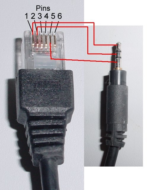

For wiring up a phono jack to the RJ12 plug it doesn't really matter, but this image shows the pin numbers on the plug:Quote:

This post is confusing to me. Your description of which pin numbers are which is right. But the part in bold isn't right. Given the pin numbering layout, you have it reversed. It should read.
RJ12 pin 5 to phono base.
RJ12 pin 2 to phono middle.
RJ12 pin 1 to phono tip.
I verified this buy lookin at the supplied RJ12 to RS232 end. Only RJ12 pins 1,2, and 5 are used. I think you just got the order mixed up.
Here is how I tested it out. I used the supplied cable from the EFI live, the supplied cable from the LC-1. Here was my logic.
RJ12 RS232 RS232 Phono
pin 1 pin 2 pin 2 middle
pin 2 pin 3 pin 3 tip
pin 5 pin 5 pin 5 base
Swap pins 2 and 3 between the RS232s and you end up with
RJ12 Phono
pin 1 tip
pin 2 middle
pin 5 base
Can you please confirm my suspicisous are right. I want to make sure I'm not overlooking something.
You're right, I got the pins mixed up on the RJ12.Quote:
Originally Posted by Kevin Doe
They are "officially" numbered 1 to 6 from left to right - when looking at the exposed pins in the plug and holding the plug pins facing up.
See image.
regards
Ok, now its clear. I found a source that showed the opposite. Either way, I'll just make sure they're in the right location regardless of number. Fantastic illustration!
