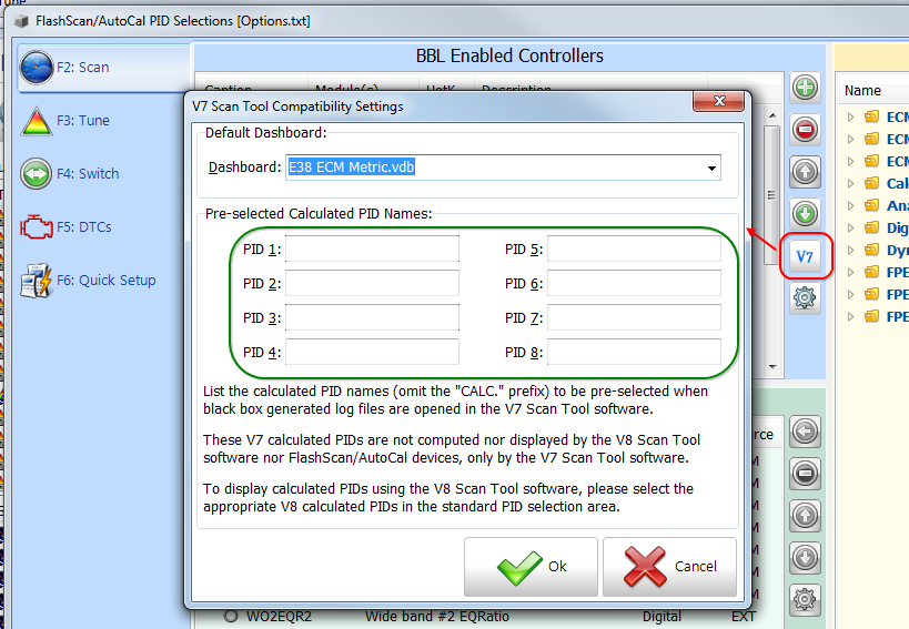

One useful thing you can do when BBL logging is to pre-define which calculated PIDs you want to be automatically selected in the log file when you do eventually display the logged data in the V7 scan tool. To do that, click the [V7] button in the [F5: BBL] tab page and you can enter up to 8 V7 calculated PID names.
Attachment 18323
Note: The calc PID names that you may enter in that window are V7 calc PID names minus their "CALC." prefix, not V8 calc PID names. V8 calc PID names can be selected directly in the PID selection list in the main [F5: BBX] tab page.

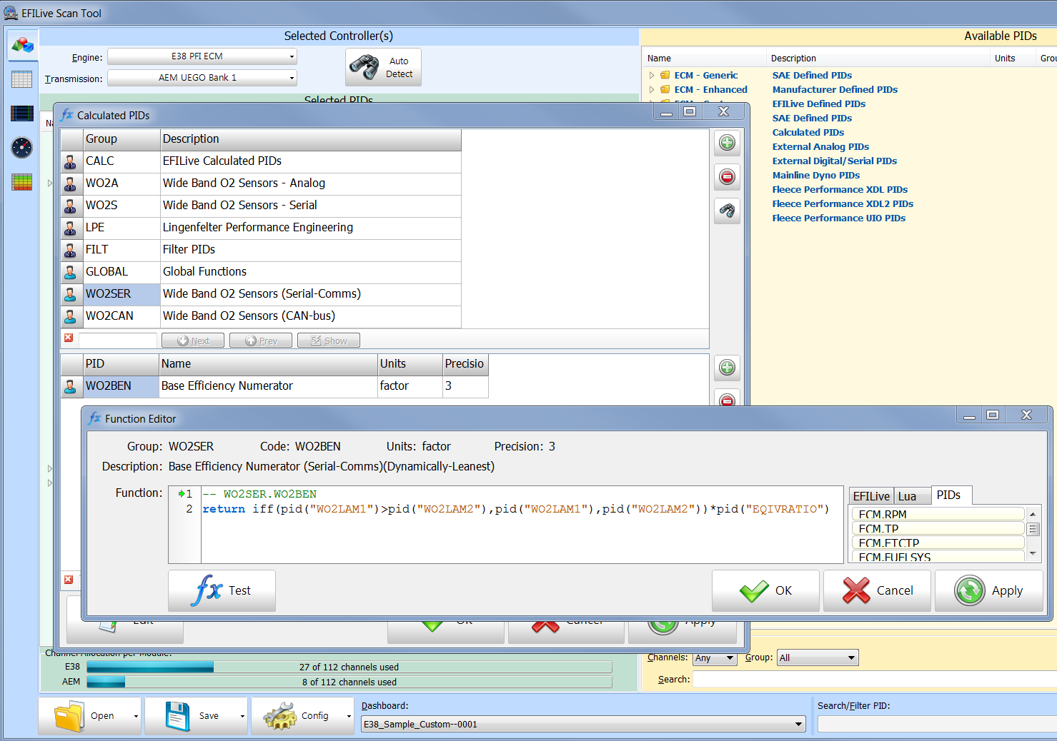

Hi Jason,
I haven't yet written the calculated PIDs documentation for V8, but here is a quick run through.

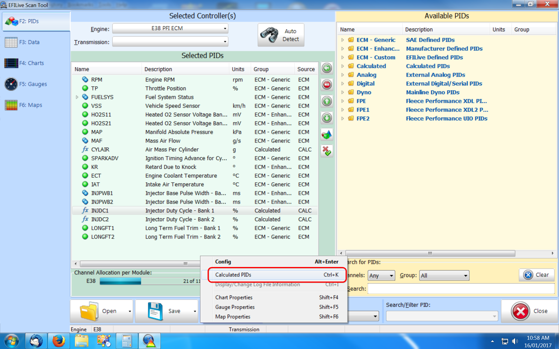

Open V8 Scan and Tune and navigate to [F2: Scan] -> [F2: PIDs]
Use the drop down on the [Config] button or select [Ctrl+K] to open the Calculated PIDs window.

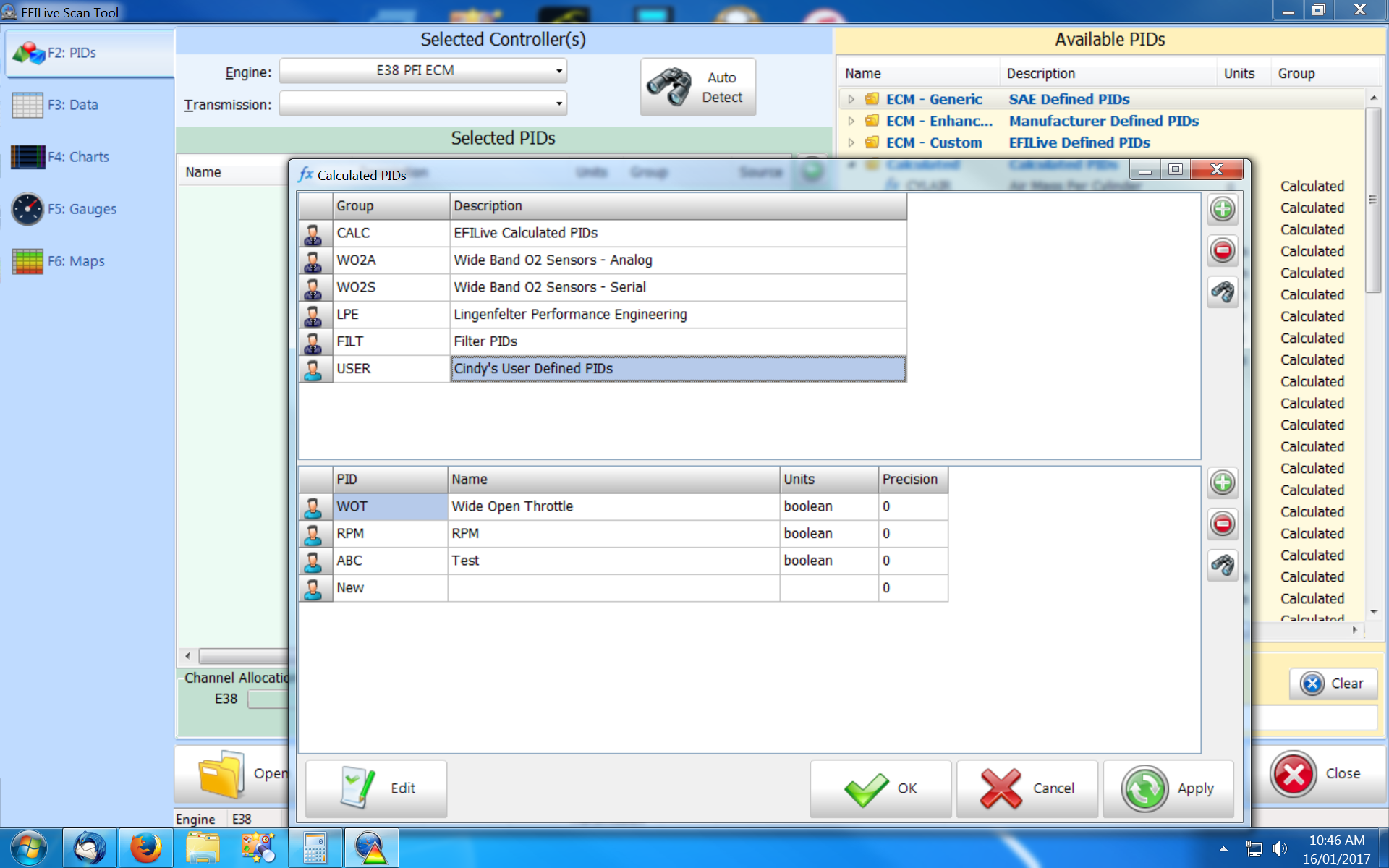

Attachment 20640
Use the +in the top window to create a USER PID Group.
Use the + in the bottom window to create your PID. Enter your PID heading details.
Attachment 20638
Select Edit or just double click on the PID to add the expression.
Attachment 20641

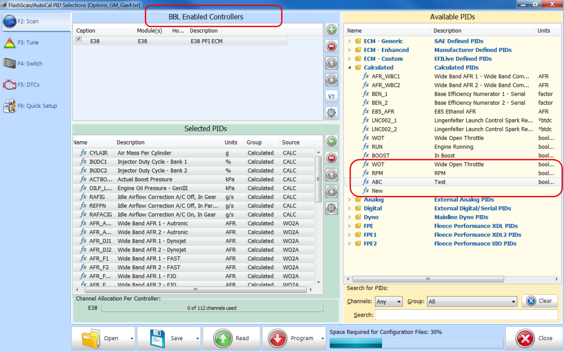

Once added and function tested and the window closed, you'll find the PID listed in both the scan tool Available PID list and the BBX Available PID list under Calculated PIDs.
Attachment 20639
Cheers
Cindy

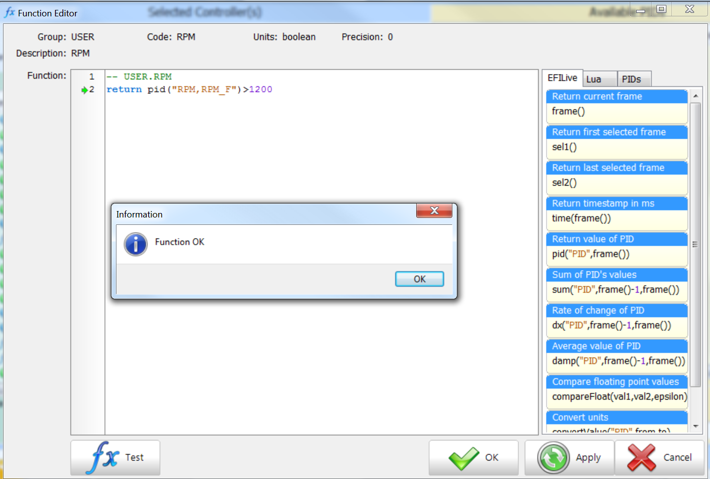

Hi Jason,
"We" as in the user.

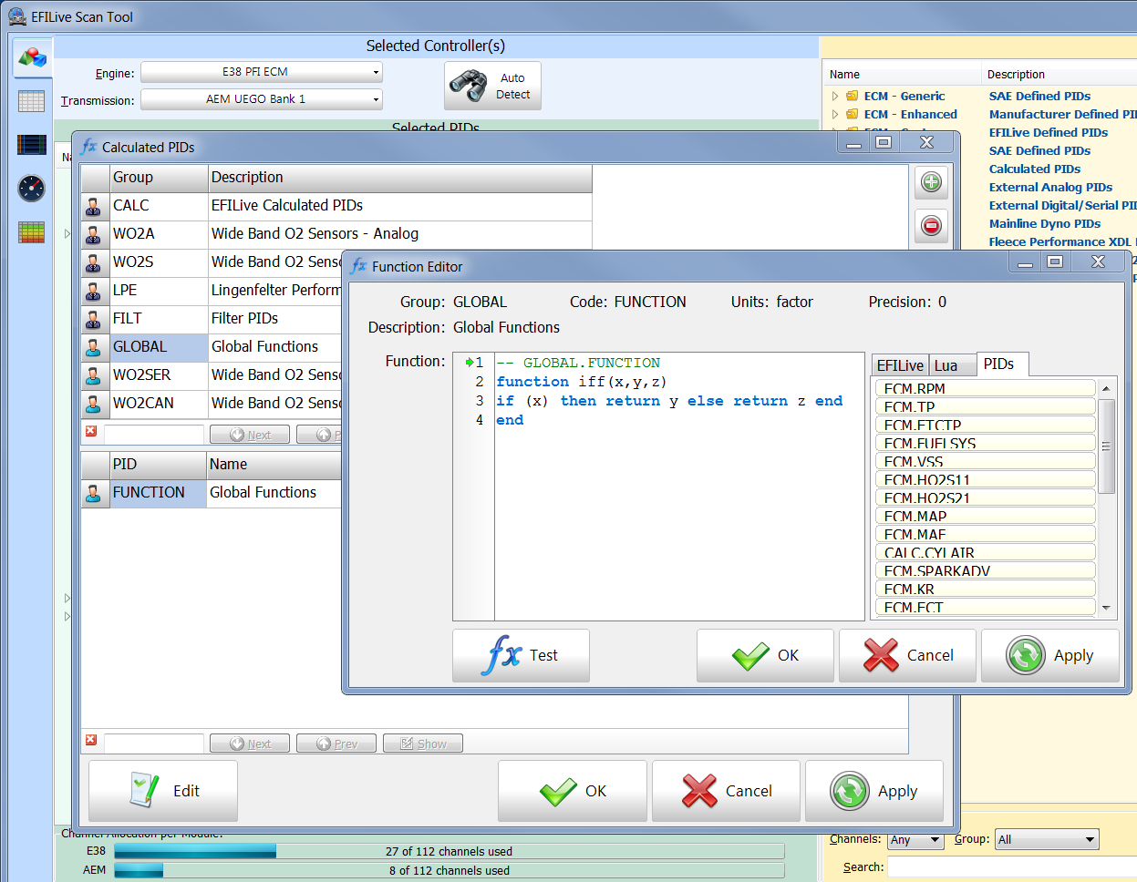

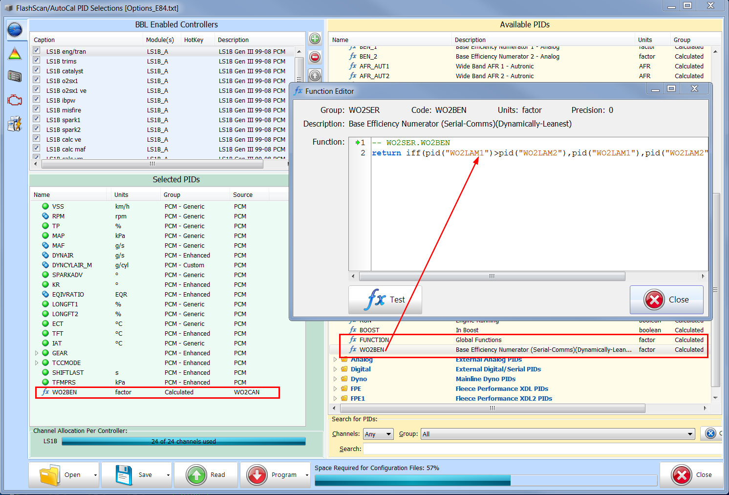

As Cindy said, you create/edit a calc in V8S&T->Scan, and then you can use it in V8S&T->BBX.
See sequence of pics below:
Attachment 20644
Attachment 20645
Attachment 20646
Attachment 20647
The calc pids are not viewable on the FSV2 LCD during logging, but they show up when viewing the log file in the scantool.
The beauty of V8 calc pids is that the pid() function can take any number of same-type pids, and it will select the one you logged...
e.g. pid("MAFFREQ", "MAFFREQ2").
