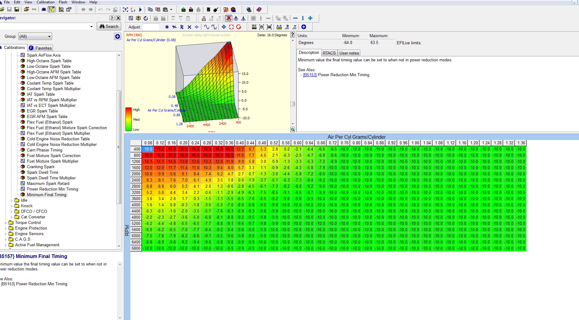

The biggest issue I had on my most recent tuning job involving a cammed 2012 Camaro was Idle with AC on and Idle speed dropping to much after a free rev.
After playing with B5157 I was able to reduce the idle hunting , Timing drop during AC kicking on , and idle dropping down during throttle blip.
Attachment 18510
