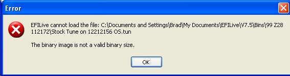

    I've been following along here: http://forum.efilive.com/showthread.php?t=3265 and reading the tutorial and I seem to be stuck.
    I have a '99 M6 Camaro with OS: 09360361 and I'm trying to upgrade to OS: 12212156 so that I can take advantage of the newer COS. I went to the Holden site and downloaded the stock M6 tune on the 12212156 OS and then attempted to open it so I could start copying all of my tables over. Here is what I'm seeing:
    Am I on the right path?

    Did you try re-downloading the file?

    Instead of downloading and saving the file I opened it directly from the site and it seems fine now. I need to remember to take the "I.T." approach before posting up here.
    Thanks for the help!

    To flash a "standard" PCM the file must be saved,
    if you make changes to a .bin and try to flash it you will get
    "please save the current calibration before attempting to flash"
    This is not the case with the RR.
