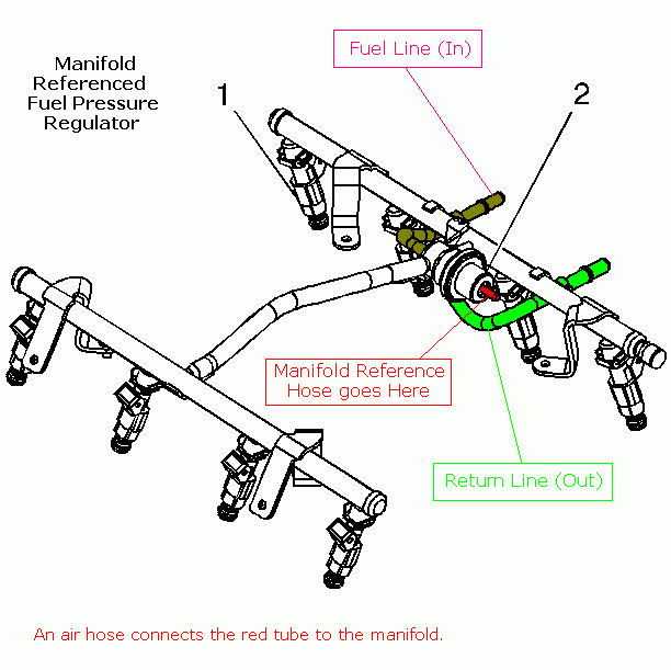

    Quote Originally Posted by eclispe1 View Post
    I thought the regulator was on the fuel rail on the F body.
    You mean stock LS1 F-body...?...no it's in the tank...
    When you look at your fuel rail, you will see a can-looking thingy connected to the fuel rail crossover tube...
    Two clues:
    - does the can-looking thingy have an air hose going to the manifold...?
    - does the can-looking thingy have an additional fuel line connected with a threaded union/nut...?
    Look closely at it... on the stock F-body that can-looking thingy is the pulse dampner (and not the FPR)... it has no manifold air hose and no return fuel line... you should see only one fuel line going to the rail.
    Do you have any pics...?
    Edit: See attached diagrams of fuel rail, which one do you have...?
    Dampner: IFR has to be sloped.
    Regulator: IFR has to be flat.
    If you have an aftermarket regulator, it will look different, be in a different location, but it will have all of these: fuel line (in), return line (out), reference air hose.
    In both cases you need to measure rail pressure.
ID:	7395   Click image for larger version.
    Last edited by joecar; March 20th, 2010 at 10:57 AM. Reason: Pink and Red are too close, changed Pink to other color
  7. #47
    Quote Originally Posted by johnv View Post
    If it is a rail mounted regulator you should be okay.
    If he has a rail mounted FPR (i.e. manifold-reference, return line), then his IFR table is wrong (it is sloped).
    From what he said, it seems he has the stock FPR in the tank (no manifold-reference, no return line), in which case it is correct that his IFR is sloped... (but does his IFR match his rail pressure and injectors...?).
