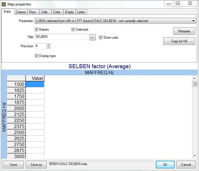

    for map A:
    - in tunetool: goto B5001 MAF table, on the tile in upper left go rightclick->Copy With Labels;
    - in scantool: edit map properties for map A, on each of Row and Col tabs click Paste Labels;
    - on Data tab click Show Names and select CALC.SELBEN, checkmark Show Units, set Precision to 3;
    - on Row tab click Show Names and select GM.MAFFREQ checkmark Show Units;
    - on Col tab click Show Names and select any pid you logged (e.g. GM.MAFFREQ);
    - on Cells tab constrain the cell width;
    - click Save As and give it a meaningful filename.
Name:	Map for MAF (CALC.SELBEN).png

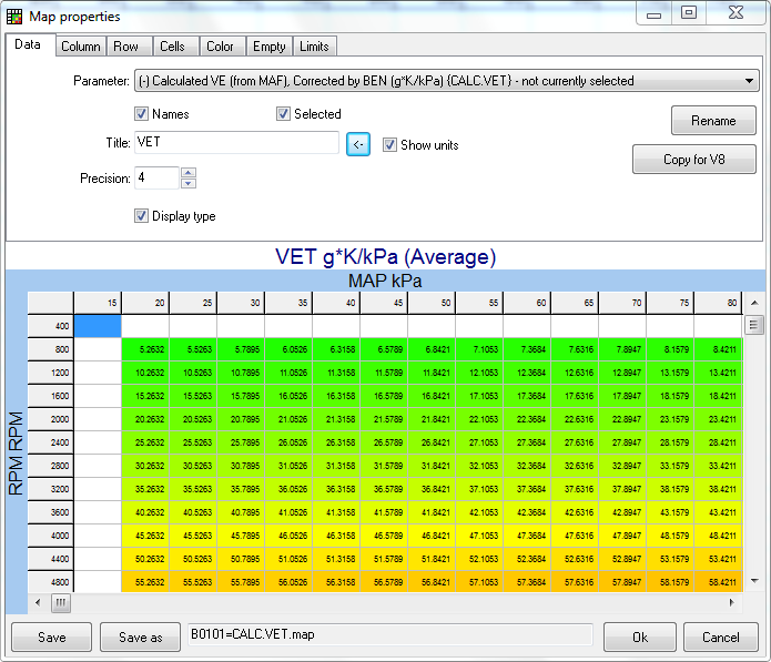

    for map B:
    - in tunetool: goto B0101 VE table, on the tile in upper left go rightclick->Copy With Labels;
    - in scantool: edit map properties for map B, on each of Row and Col tabs click Paste Labels;
    - on Data tab click Show Names and select CALC.VET, checkmark Show Units, set Precision to 3;
    - on Row tab click Show Names and select SAE.RPM;
    - on Col tab click Show Names and select SAE.MAP checkmark Show Units;
Name:	Map for VE (CALC.VET).png
    See attached zip contains those 2 maps already made (unzip and copy to \Documents\EFILive\V7.5\Maps): Maps.zip
