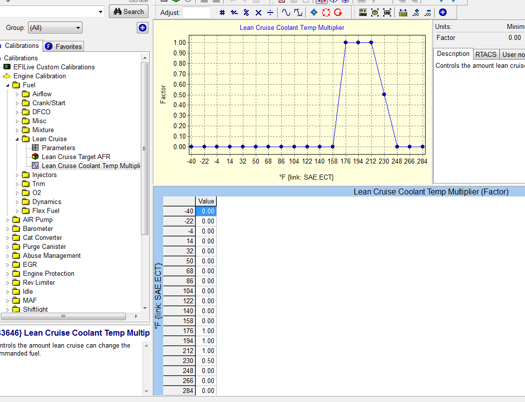

    I guess my question goes along with this post. I'm working on lean cruise in my 2003 GMC Sierra Denali. 6.0L, 4L65E, Volant CAI w/ scoop, '06 silverado e-fans, corvette servo/3-4 piston. Otherwise totally stock.
    I enabled lean cruise via the CAX file and found OEM lean cruise setting from a holden "1 tonner". Problem is I don't yet have WBO2's in this truck and am curious how far I can go with this without being able to see actual fuel ratio. I haven't loaded the tune with lean cruise just yet. just wanted to be sure. So am I pretty safe at these factory setting? Take it a little further? Below are the factory settings from the holden tune.
    will the Lean Cruise Target AFR table have to be changed due to the slightly bigger engine?

    You absolutely should use a WBO when initially configuring LC. The values in table B3639 (Lean Cruise Target AFR) are in EQ. These are subtracted from the stoich value in your tune (EQ of 1.00).
    If you look at the 2400 RPM row you will see a value of "0.1426" - this subtracted from "1.00" resulting a commanded EQ value of 0.8574. If your stoich value is 14.68:1, this loosely equates to an AFR of 17:1. LC does NOT use the NBO for fuel trims - it runs directly off your VE table. So if your VE table is inaccurate, the commanded fueling during LC will also be inaccurate - being overly lean is a real possibility.
    Also, if you plan on trying to run LC in town, or on any route where there are intermittent stops (traffic lights, stop signs) you may want to consider reducing the value of B3635 (Off Idle Timer) - 150 (seconds) is your current value. This means LC will not engage for 2 1/2 minutes after any stop (idle condition). I generally set this to 10 seconds.
