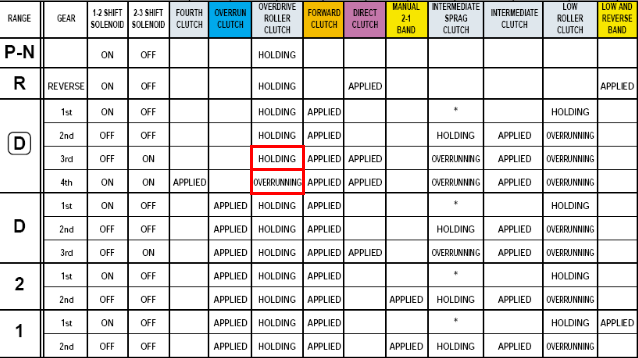

    This is what I understand is happening (but I'm no expert):
    when shifting 4->3 the overdrive roller clutch keeps overrunning (fails to hold) until you relax the throttle (and then it starts holding).
    when shifting 4->3 the overdrive overrun clutch keeps overrunning (fails to hold) until you relax the throttle (and then it starts holding).
    If the shifter is in the 4th gear position, the overrun clutches will never come on. The overdrive roller clutch holds power for all forward gears in the 4th gear shifter position (if it was broken, you would never have 4th gear, reverse, or any forward gear with the shifter in the D4 position).
    Ah, sorry, my typing misadventure, I meant to say overdrive roller clutch...
    it may not be broken...
    for some reason can it fail to grab after freewheeling...?
    for some reason can it fail grab after freewheeling...?
    I would say not a likely scenario, usually when they fail, its either slipping in all gears, or completely fail.
    OP, Did you do anything to the VB during the rebuild? I'm thinking maybe an AFL valve issue or possibly a weird acting shift solenoid. If Solenoid B kicks off (for whatever reason) it will act like neutral because it would be 1st gear, but since the shifter is in the D4, you wont have any engine braking.
